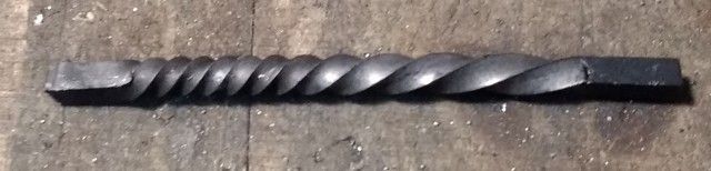

This is the method I used to twist some 3/16 square brass rod. This brass rod was bought from the Harrogate Show, and the seller said it was a grade that would probably break if I tried to twist it. But I had a go, and it worked fine, and the pitch comes out quite even.

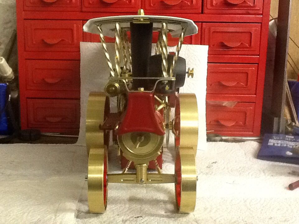

I made the Barley Twist to upgrade the Wilesco Showmans Engine I bought for someone as a birthday gift in 2015. The Wilesco method was simply round brass rod with a coil spring slid over it to give a crude effect of Barley Twist.
Years ago when I used to make gates and railings I would use the same method to put a twist into a portion of 10mm steel square bar, later using an old lathe.
