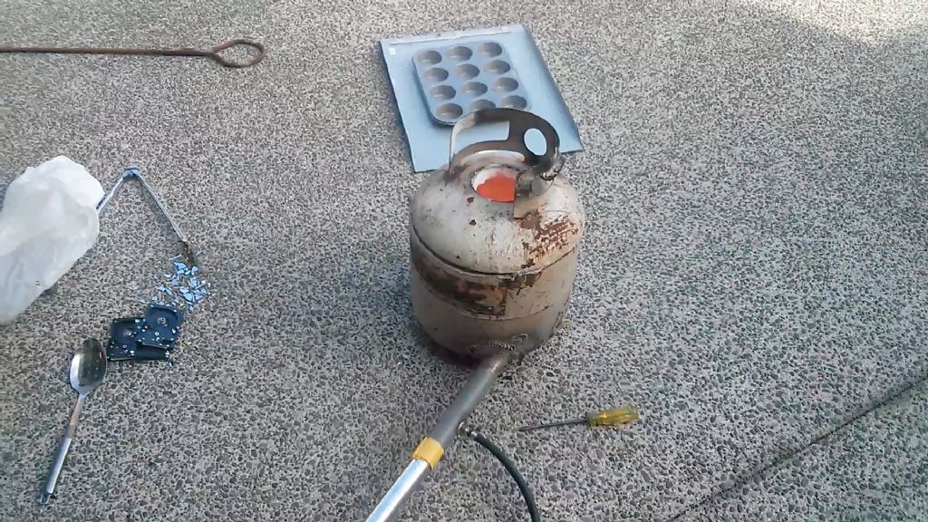

      On a whim I bought 10 tungsten electrodes used from an arc furnace. Furnace sadly not included. 1/4" tungsten rod woth a 5/8" copper contact on one end. Length varies a bit but is generally around just under 3".
      The reason I post is to ask whether or not anyone has a good idea of how to make the electrics to make these strike an arc and melt metal.I do have a cheapy arc welder but the electrodes are too big to fit in the stinger. I have just amount enough electrical knoledge to recite V=IR and P=IV but apart from that I'm gonna need help from someone else.
      I was hoping to be able to melt fairly small amounts of metal for casting. Aluminium as a minimum. Cast iron would be nice. If I could manage to melt steel I wouldn't be complaining but that might be excessive.
      I've seen youtubers melt tungsten with their TIG welders but I haven't got one of those to hand.

                    I'd go with LPG (propane) – like this made from a 9 kg gas bottle

                      Not certain I understand why you would be dimming neighbourhood lights or paying massive 'leccy bills. You only need to insert enough energy to heat up the metal to melting point and overcome the insulation losses for the duration. If you start with a similar power rating to a commercially available (hobby-sized) furnace, you won't be far off. Conversely, you might argue that the insulation needs to be good enough to keep the power requirement below a few kW.
                      If you decide to try using a welding source to drive the arc(s?), be aware that few of them are rated for continuous operation so you may be disappointed to find it cutting out before you are done. Rationally, you might be best off using a combustion-powered heater unless you happen to have an industrial welding source available.
