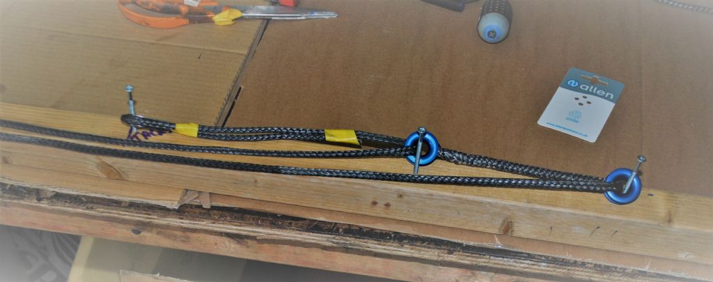

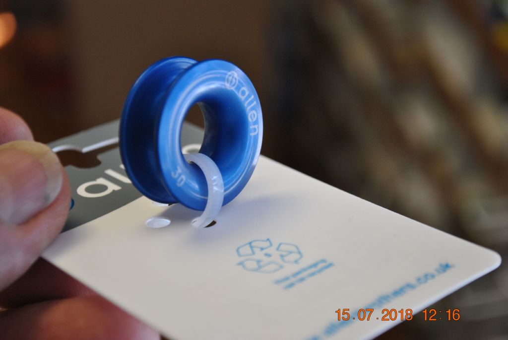

      I want to make some friction rings in stainless steel similar to the one in the picture ( the second picture shows it in a typical use instead of a pulley) .
      I know I can buy them ( very expensive) but that is not the point of my question.
      Can someone tell me how they would go about making one please. I have the stainless steel bar. the hole in the middle is no more than 15mm diam( prefer 10-12) so I can drill that. But how do I form the inner curve but what shape is the cutter to get the clearance? If the cutter is made as a full form tool I am pretty certain my Warco 250MV will have too much chatter.
      Once I have the inner curve I suppose I can grip the item in a shaped mandrel & then deal with the outer internal curve but once again the curve does pose a problem as any form tool will be rather large. It has to be very smooth to allow ropes to pass through under high load without any damage
      Any ideas please

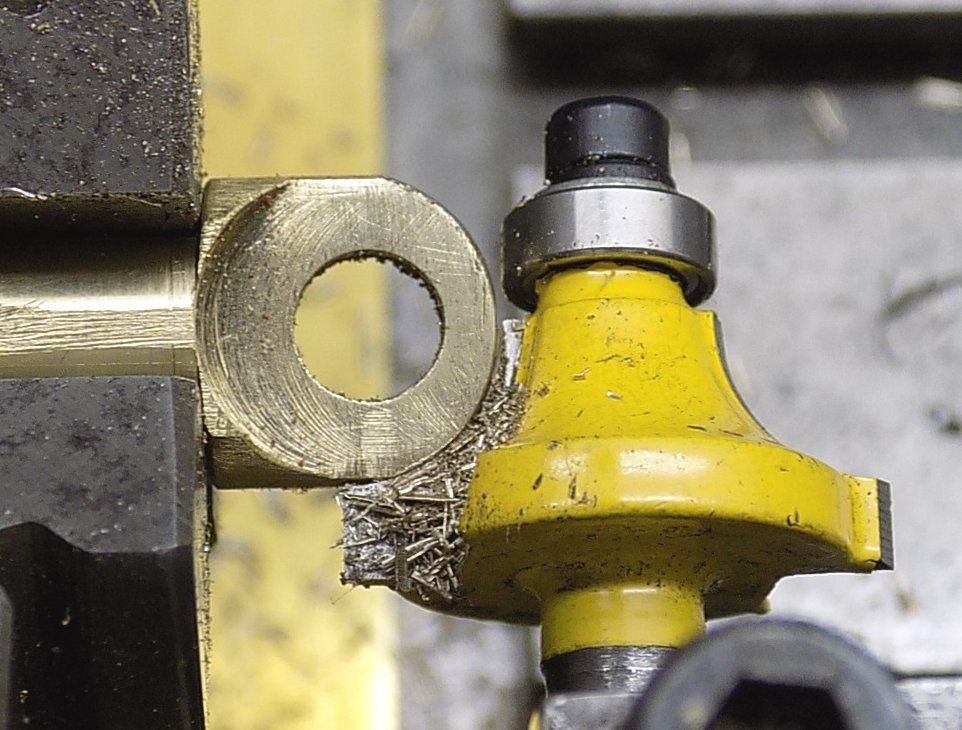

                                    Hi Sam,
                                    It might help to look at carbide router bits !
                                    Edited By John Baron on 06/09/2018 12:05:34
                                    #370639
                                    Mick B1
                                      @mickb1
                                      Posted by John Baron on 06/09/2018 11:15:20:
                                      Hi Sam,
                                      That'd be my first resort, too, held in the tailstock drill chuck if that blends correctly with the centre hole, or in the toolpost if not.

                                        Its taken me nearly an hour to post a picture !
                                        Put your own expletives in !
                                        #370647
                                          Use about half the speed you would if cutting steel and treat it as a 20mm dia cutter.
                                          I would have thought you want 316 stainless for marine use.
                                          Hopper that is a hand graver being used to do the blending in my 4th photo (HSS woodturning scraper actually)
                                          #370649
                                          Mick B1
                                            @mickb1
                                            Posted by John Baron on 06/09/2018 12:07:27:
                                            Hi Guys,
                                            I use router cutters the same way – but often remove the end screw and bearing if it gets in the way.

                                                  Sam As I said earlier a router bit would be OK in ali or brass which I have used them on in the past but I too would have my doubts about using one on stainless but that is just gut feeling.
                                                  #370671
                                                  Mick B1
                                                    @mickb1
                                                    Posted by Sam Longley 1 on 06/09/2018 13:24:58:
                                                    Are router cutters really up to the task? In the past I found that a router cutter has only had to look at a piece of steel to shatter & stainless steel would surely be a step too far!!!
                                                    I do have a few but do not want to smash them needlessly
                                                    Just today I've used one to round off a pair of trunnion brackets for the carronade model I'm making, in a quite similar manner and size to John Baron's pic. You need to be a bit gentle with them, and I don't think I've used them on stainless, but with care they work well.
