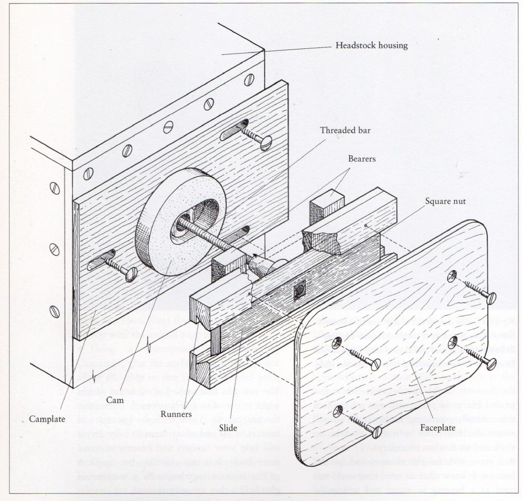

        There is a jig that woodturner make which will turn an eclipse whether it could be adapted for use on an metal working lathe I do not know. I am sure that I have a book in my library that has a jig in it if I can find it I will let you know

          #362574
          Dalboy
            @dalboy
            I found the jig but I don't think that it will be what is needed. Here is the diagram of it can not show any more.

                              #362902
                                Posted by Derek Lane 2 on 17/07/2018 09:48:06:
                                Thanks, Derek
                                I've located the web-page that describes it : **LINK**
                                http://www.aawcontentsource.org/aaw_cs1_pdf/AW3006p28-35.pdf
                                The design appears to be a wood-turners version of the Holtzapffel Ellipse Chuck : **LINK**
                                http://www.ornamentalturning.co.uk/ellipse_chuck.pdf
