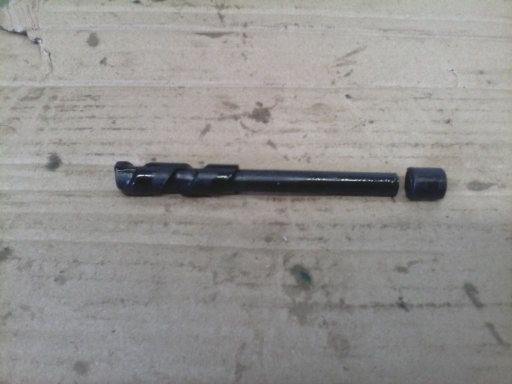

        Hi
        I am trying to turn down the diameter of a 12mm Acetal rod to 8mm. I have tried a CCMT insert which does not seem to want to cut it. Sort of half cuts and deforms it.
        Does it want to run fast or slow?
        If I used HSS what is the best shape of tool to use?.
        Should I use lubrication?
        Any other hints?
        Adrian

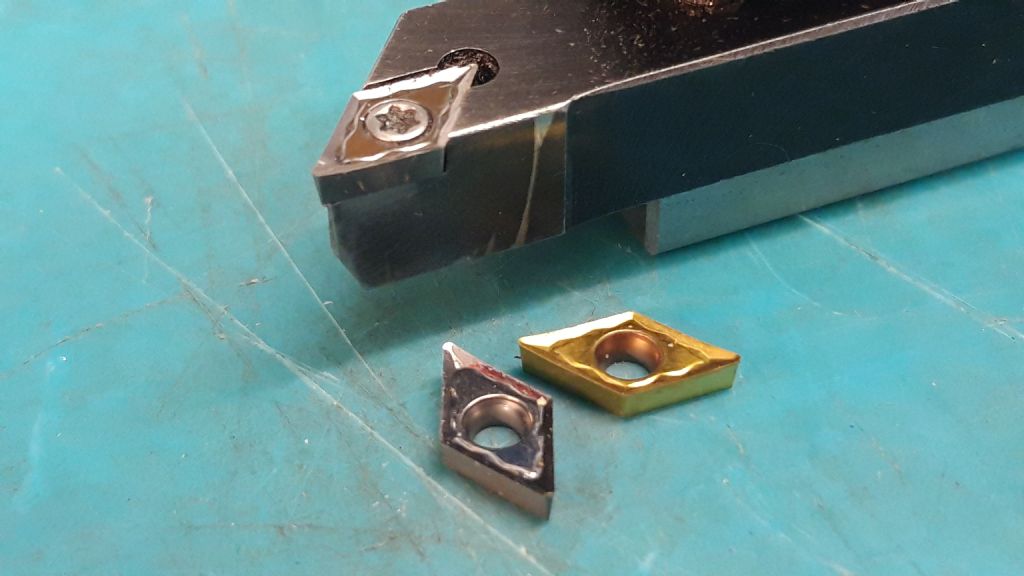

                          The CCGT (which is ground to a polished sharp edge) should work very well indeed on delrin, which is also a joy to machine (if the tool is sharp)..
                          The CCMT does not have a sharp edge at all! It is suitable for taking a deep cut on steel at high cutting rates, where the material at the cutting edge is raised to temperatures where it becomes soft (even close to red heat at the cutting edge). It is totally unsuited to shallow cuts on steel, or on plastics
                          Hope this helps – I have been through this; some CCMT may be good for shallow cuts on steel, some is not, but I recommend CCGT for plastic.

                                      Thanks for all the replies, I will give the HSS a try. I am trying to replace the broken oil pump/lift in my mill. Which in the parts list is called a Muddler. Which a dictionary tells me is a drink stirring stick.

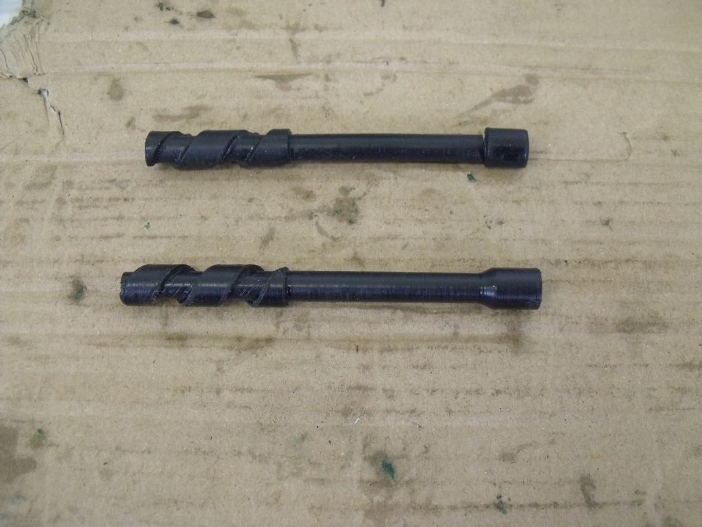

                                          Well it turned out OK in the end, I made a couple of mistakes which ruined the finish in places, but I am happy with it.
                                          I rounded the part that broke and the camera angle makes it look a lot longer,

                                            How did you cut the helix? Looks very coarse for a ME type lathe.
                                            #414509
                                            AdrianR
                                              @adrianr18614
                                              Yes it is coarse, it is 19mm pitch. I cut it on my ML2, I luckily had enough change gears to give me a 1:6 ratio i.e. lead screw 6 times faster than spindle, which gave me a pitch of 3/4". As I was overdriving the lead screw, I drove it from the lead screw by hand cranking the hand wheel.
                                              I used a narrow parting tool with a lot of rake, and made multiple passes with the left right offset supplied by the cross slide. The swarf was not completely cut free on by the tool, so I had to use a Stanley knife resting against the parting tool to occasionally gut the swarf away.
                                              Unfortunately my flexible drive is still in my old workshop down south, If I had that I would have tried using a router/milling cutter with the drive mounted on the cross slide.

                                                Presumably it's not just rake you'd need when cutting, but a helluva lotta trailing side clearance to avoid rubbing on the helix angle.
                                                I meant to ask: would have been easier to find a way to re-use the business end of the existing stirrer by joining to a new stem in some way?

                                                  That turned out nice. Looks like a very aggressive square thread! And there is always more than one way to get the job done.
                                                  I tend to use tips with a good positive top rake for all my general machining these days, and apart from form tools I try to avoid grinding HSS, it's just too messy!!!. My favourite tips are these DCMT 070204 with the ground/polished finish, they will machine anything, brass, aluminium, steel etc. and are very good on plastic especially Acetal.
                                                  Ian
                                                  Carbide tips

                                                    Ian where did you get those particular dcmt inserts from if you dont mind me asking, thank you.
                                                    #414607
                                                    Ian Johnson 1
                                                      @ianjohnson1
                                                      Hi Martin I get those tips from JB Cutting Tools. They usually have a stall or two at classic bike shows (Stafford), steam fairs or model engineering shows. I think you can order on-line too although I haven't tried that yet. I don't know the technical specification for the tips, but if you ask Jenny she will give you the same ones, very good quality. About £3.50 each Silver or Gold I think they are the same spec, gold is prettier though!
