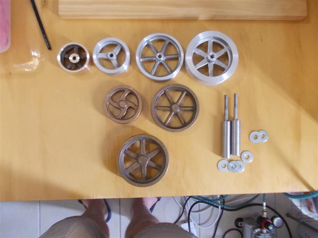

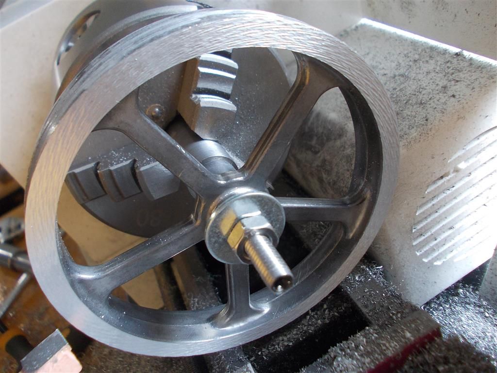

        I have been digging into my box of flywheels to see what I could do with them now that I have steel mandrels to work with. The smaller wheels can be gripped from the outside of the rim, the larger wheels can be gripped from the inside of the rim and some of the wheels can be gripped by the hub if nothing else will work. I am getting a very good finish using the mandrels.The photo bellows shows four wheels that have been machined (top row), two wheels which can be machined (middle row) and one wheel (bottom row) which will need a face plate as there is no hub to grip.
        But I have one aluminium flywheel (last photo) mounted in my lathe now which is giving me some unexpected problems. There was a large hub to grip so after getting it to run true in the chuck, I faced off the hub and drilled out to 6mm. But when the mandrel was fitted to begin machining the outer edges I am getting a ''fish scales'' pattern accompanied by a bell-like ringing sound. I have not come across this sound before. I have adjusted the speed higher and lower and I have changed tools. I have also tried different angles for the tool but nothing seems to work. Any suggestions ?
        UPDATE : the wheel makes that ringing sound even when I strike it lightly with a wooden paint brush. Perhaps this wheel is the perfect size for vibrating which is making it awkward to machine using a mandrel ?

          The tool is chattering at a high frequency which is the ringing you can hear and the cause of the patterned surface. Basically the flywheel being larger than the others is not supported enough and is flexing away from the cutting tool.
          Try slowest speed, very fine cut, very sharp tool.Use the tailstocj ctr to support the mandrel

            I have tried everything except the tailstock centre (I should have thought of that…thank you ) . I have to take my wife somewhere now but I will give it a go tomorrow.  I really think that this one will need the face plate.

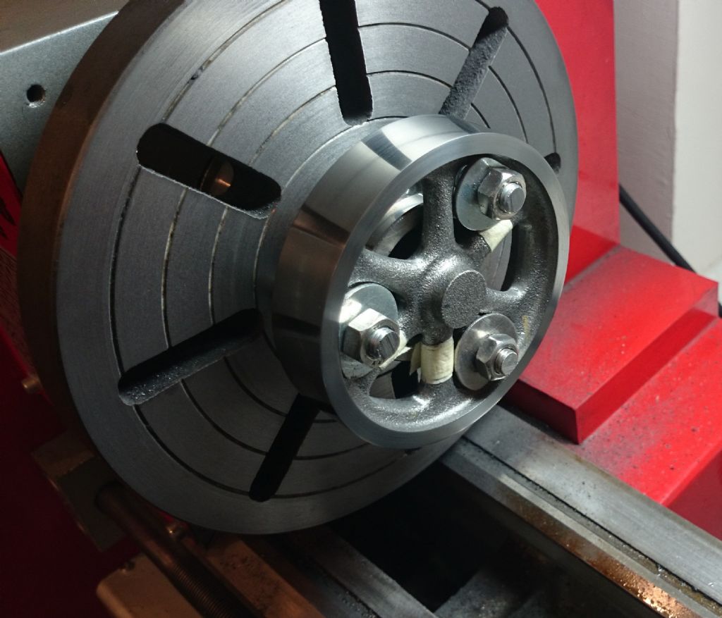

                    Mine runs ok having used this method…..

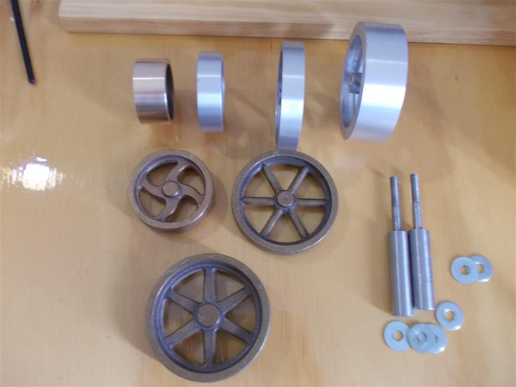

                      I used the tailstock centre and that helped a bit. I decided I would machine the main outer surface first. After I did this the outer rims machined much more easily. Perhaps it was because the wheel was now more balanced.
                      I also have the same flywheel in brass and this was even more difficult. I used the tailstock centre, machined the outer surface first but nothing was working. So then I changed tools and used a sharper angle on it. I also slowed the chuck speed right down. Once I got the outer main surface finished I then finished the outer rims. It eventually turned out well.
                      I have now machined six flywheels and only two more flywheels (both brass) to go. A couple of them are not good castings ie. there are some small air bubbles in them but they were cheap and it is good practice.

                            Brian if you look closely at Michaels first photo you will see a ring behind the flywheel just inside the three fixings packing it out from the faceplate. The idea is that you support one side of the spokes as close to the bolts as possible and clamp on the other side which avoids distorting the flywheel if it were only the rim against the faceplate.
                            It also allows you to machine the whole of the outer face without running the tool into the faceplate

                              Why is there tape on some of the spokes in that photo ? The tape does not seem to be doing anything. It is not on every spoke.
                              He has also taken a cut around the hub. I guess that is optional ?

                                I would hazard a guess that not all of the spokes were touching the packing ring as castings are seldom perfect, a few winds of take will thicken them up a bit so all six contact the packer. Tape in the second photo is so the jaws don't mark the finished flywheel

                                        Sorry, forgot to mention the packing. What you can see behind is a bearing inner race being used as a spacer that I had thrown in the 'come in handy' box. Jason is correct the tape on the odd spoke is because all the spokes didn't sit flat against the spacer.
                                        If I did it again I would pay more attention to how well the inner of the outer ring (between the spokes) of the casting was running true rather than the central hub as the outer ring is more obvious if it is not running true, or if I had found there was not enough hub material to clean up find a better compromise.
