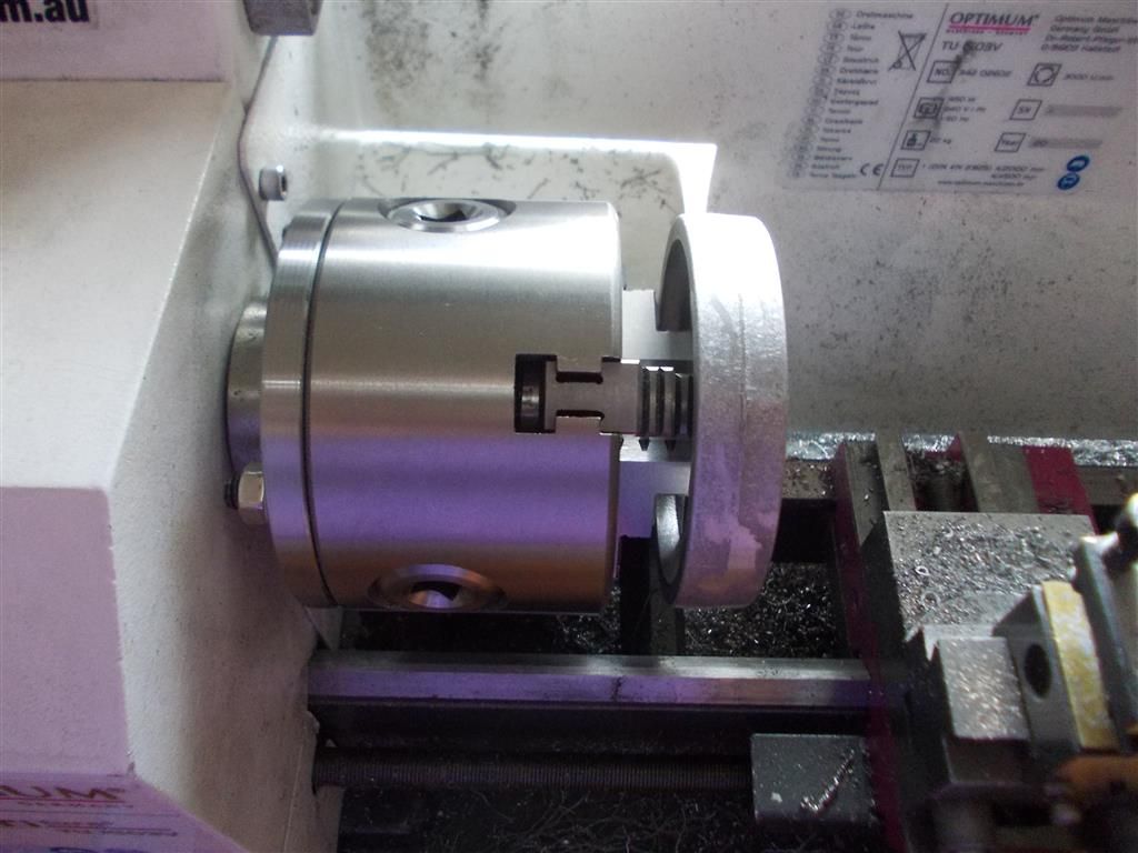

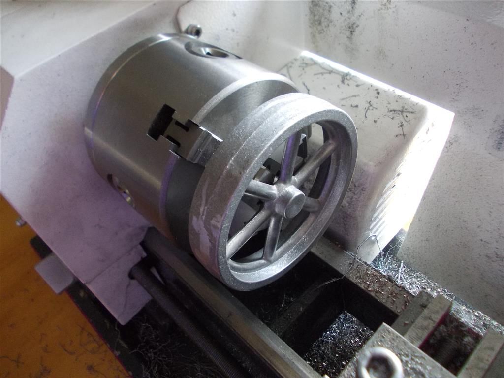

                            I have been machining flywheels using my newly made steel mandrels. Everything was okay on the smaller flywheels (50/60mm) but then I had a go at some of the larger flywheels and struck a problem. The 75mm diameter flywheel cannot be held in my lathe chuck ; my lathe is too small. I have tried both internal and external jaws and I cannot get a good safe grip. I only need to face off the hub and drill a hole for the mandrel/axle. I can then fit the mandrel and do the outer rims and the outer surface.
                            There is a 10mm diameter hub with 5mm sticking out. is it safe to grab the flywheel as per the photos ? I cannot see any other way to do it. The flywheels are aluminium and brass so they are easily machined.
                            Some of my other flywheels do not even have a hub sticking out so I think a face plate is the only option with those.

                              Have you tried the jaws that you have fitted at the moment but opening them outwards so the step on them grips the inside of teh flywheel?
                              #206419
                              Brian John
                                @brianjohn93961
                                Yes, I tried that but by the time the step has reached the rim of the flywheel then the jaws are out of the chuck thread.
                                #206421
                                  Looks a lot closer in the photo, use the step nearest the chuck body

                                    Faceplate would be best and machine bore and outside diameter at the same time.

                                      Jason, no it will not work like that. I have fiddled with it many times. it cannot be gripped on that first step (nearest the chuck body) as the second steps (closer to the centre) will not pass through the spokes. With a different spoke configuration it may have been possible.
                                      David : yes, I think a faceplate is the only answer but there is no face plate for this model so one will have to be made. I am having problems getting the chuck off to see what fittings are required as the nuts are on VERY tight ! I will have another look tomorrow.

                                      Bob Brown 1
                                        @bobbrown1
                                        Why not get a piece of material and machine it such that held in the chuck it acts like a face plate you can then drill and tap some holes in it to clamp the flywheel to it bit like a jig. To ensure the face is square just take a skim off it before clamping the flywheel on.
                                        Bob

                                            Brian,
                                            My advice: Buy a small faceplate [any suitable size] and make a spigot to fit it.
                                            Clamp the spigot firmly in your chuck and away you go.
                                            … it probably won't run perfectly true, but you will be levelling the Flywheel blank anyway and I think it's the safest option.

                                            Hopper
                                              @hopper
                                              In the absence of a faceplate, you might be able to undo the three or four nuts that hold the chuck to the flange on the spindle. Then use the flange as a faceplate by holding the flywheel to it with some nuts, bolts and washers. Or get a disc of ally from Norweld and bolt it to the flange then face it off and drill bolt holes wherever you need them. Tonkins also often have steel discs on the offcut bench — "holes" from larger jobs on the CNC laser cutter.
                                              Your lathe will take a much larger chuck than the one it came with. I would recommend a four-jaw independent chuck. You are going to need one sooner or later for holding castings and other non-round items for machining. A 125mm four jaw is a very handy thing to have, if it will fit your lathe. If not, a 100mm is pretty handy too.
                                              For the flywheel in your picture, you might get away with holding by the hub like that. Take light cuts and drill gently. You may have to rap on the rim of the flywheel with a soft hammer (aka handle of a screwdriver) to get it running reasonably true before starting to machine the hub.
                                              Or at a pinch, you might be able to make a simple face plate out of a piece of 20mm thick wood with a hole bored thruogh the centre, say 50mm diameter, that you can grip with the chuck jaws from the inside.  Does the tai tai have a cutting board and do you have the skill to explain how a 50mm hole appeared in it?

                                                    The slightly larger flywheels that I have CAN be gripped by the inner rim. I think that this is just an awkward example which will require the use of a face plate or by carefully gripping the hub. I think I can see how a ''face plate'' can be made to fit this chuck ie. the ''face plate'' held in the jaws and the flywheel then attached to it.
                                                    I have to go to work now but I will think about this tonight and look at the problem again tomorrow.
                                                    A four jaw chuck and a fixed steady for this lathe has been ordered from China but the Australian company does not know how much it will cost or how long it will take to get here.
