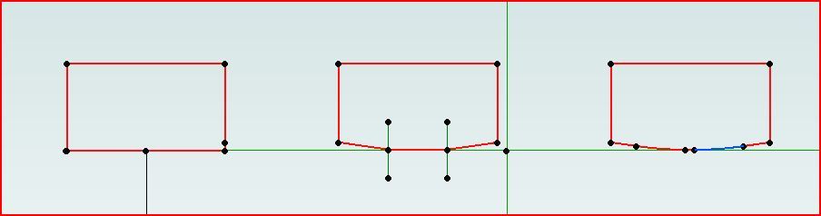

            Is it tricky to machine the crown ? I do not really need it on my flywheels but it might be worth trying.
            #157191
              I thought that might be the next questionwink 2
              As shown below from left to right
              1. Turn the sides and face of the flywheel to clean them up
              2. roughly divide the face of teh flywheel into 3 and then by setting teh topslide a degree or two either way turn a shallow taper on teh outer two segments
              3. With care while the lathe is running use a file to blend in the areas where the tapers meet the central section, then finish with Emery cloth backed by a bit of flat wood.
              On larger flywheels and pullies you sometimes have to use 5 facets not three, you should just be able to see the changes in the metal surface where this pully had the 5 facets done
              And the finish after filing and finishing

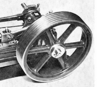

                As well as flat and crowned flywheels, they may be made with rope grooves, like this. This is a Stuart Turner S9 Ian S C
