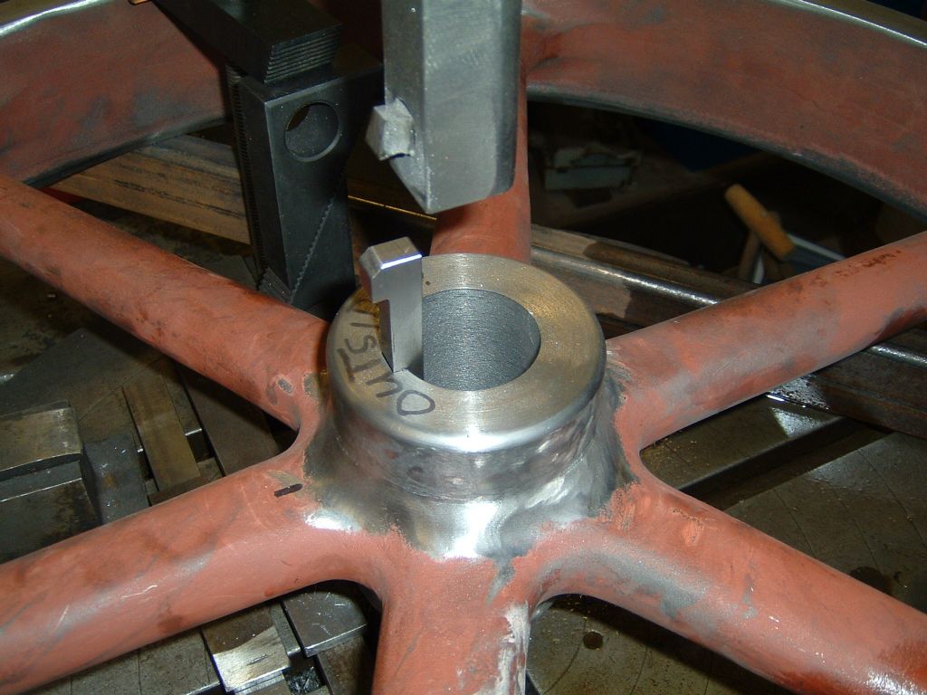

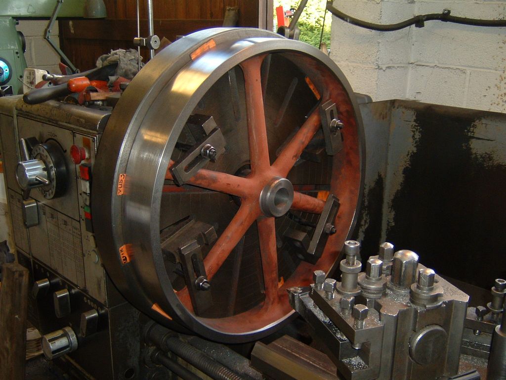

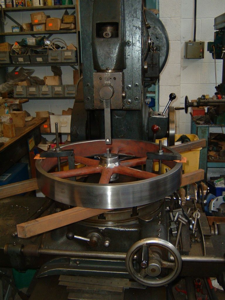

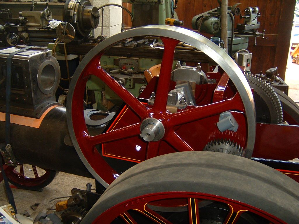

                  RICHARD GREEN 2
                    @richardgreen2
                    Here are a few pictures of machining the flywheel for my 6" Burrell, the flywheel is 25 1/2" diameter on a 27" faceplate, the keyway was cut on an 8" slotter.
                    Richard.

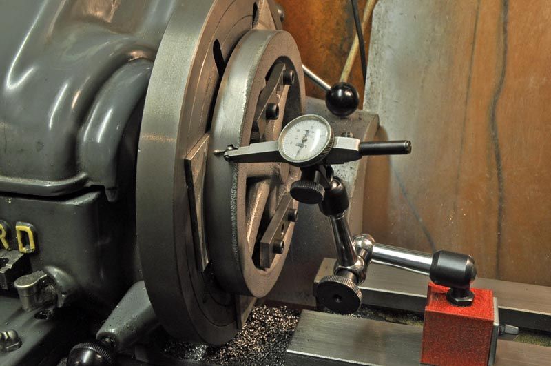

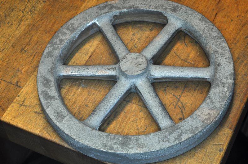

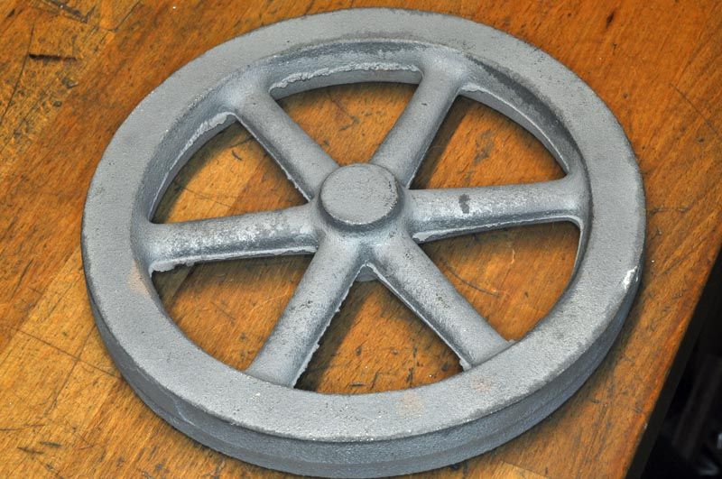

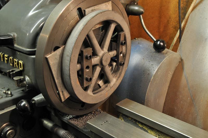

                    #152939
                      Where possible I prefer to hold the flywheel by the inside of the rim using the 4-jaw as there is not the problem of keeping bits of packing in place or distorting teh flywheel by clamping onto unsupported spokes. This is not always possible if your chuck is not big enough or the number of spokes gets in the way, 5 spoke flywheel ssuffer with this and really need a faceplate.
                      This shows the sequence that I used to machine a 10.2" flywheel, although bigger than yours its the same principal just a smaller chuck and smaller flywheel.
                      These are a couple of shots of a 9" 5 spoke that had to be done on a faceplate, the MDF packing supports the spokes so the clamps don't bend them and also allows the tool to cut past the outside of the rim without running into the faceplate
                      These 9" ones had a long central boss so that wa scleaned up first then used to hold the flywheel by to do the rest with a bit of tailstock support for good measure.
