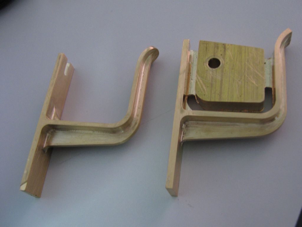

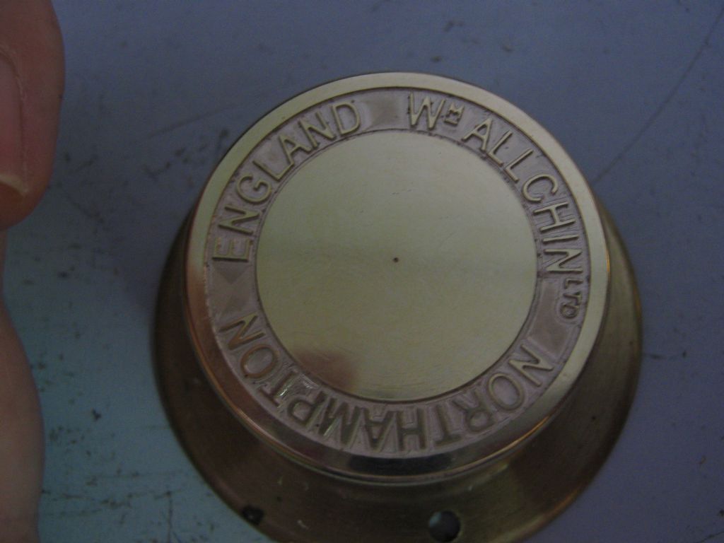

            These were done using Vectric 2D.
            Allchin hub with correct engraving
            Allchin hose brackets

              Although this was cut on a laser all the artwork was done in VCarve pro ut it could have been done in Cut 2D

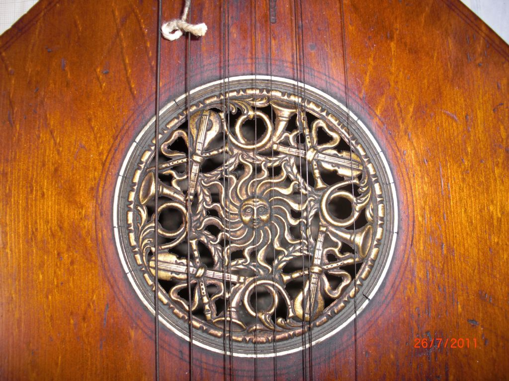

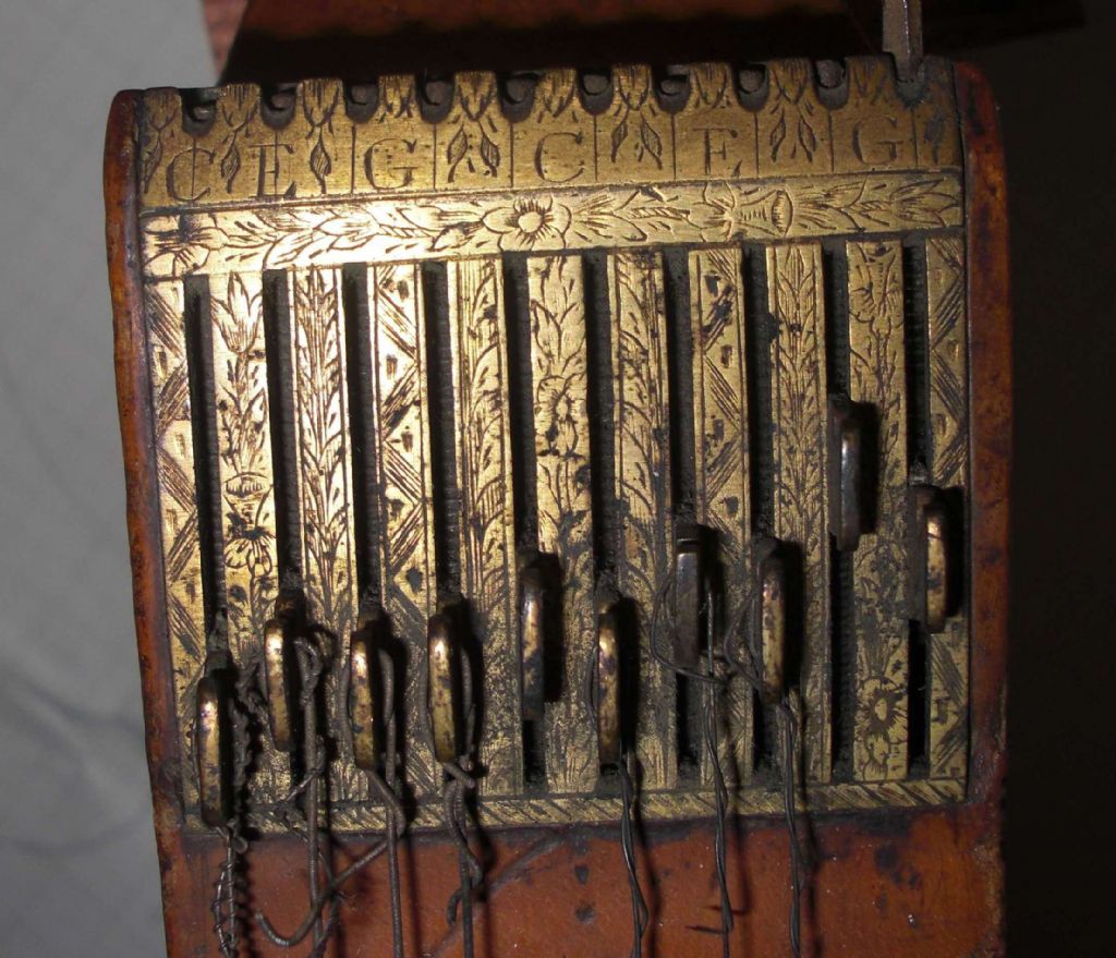

                Here are some examples of the things I want to machine and engrave (once I've managed to do a more simple S-shaped crank handle):
                The top one is brass. The lettered area slopes back at about 10 degrees and the body has 3 horizontal tabs out of the back which are drilled to allow 10 square-topped leadscrews to operate on the lugs that you can see in the slots
                The lower one is brass or bronze
                Will draftsight and cut2D allow me to do these or would I need something like vcarve?

                      Those examples you posted have 3D profiles on them, they are not flat.
                      Cut 2D or VCarve pro only works in 2.5D. Aspire, the flagship model will do these but if you think VCP is expensive then this is out of your range.

                                  would I be able to use Cut2D for the part shown in the first photo if I machined the front face (slots and engraving) then put it on a sine plate at 10 degrees to machine the angled face?
                                  Neil: it's a type of 18thC Cittern known as an "English Guittar"
                                  The rose shown in the second photo is a casting but I was hoping to find a way to machine them. Some 18thC luthiers made star roses from bone, ebony and box so that's my fallback if I can't find a way to copy the one in the picture.

                                    Yes Cut 2D would do that but it justs engraves the letters.
                                    Where VCP differes is that it can do vee carving, what this does is it uses a vee shaped engraving cutter with a tiny flat on the end. and cuts out as normal until it gets to the outer edge and then when it gets to a corner it automatically raises the tool until it reaches the corner then lowers it.
                                    Even thought it's machines like a hill top with two valleys you only see the sharp corner, In Cut2D, Sheetcam and Cambam you will get the radius of the cutter showing in the corner.
                                    Not the best picture in the world, zooming in hasn't helped but if you look at the W's and Y's you can seee a crisp serif.
