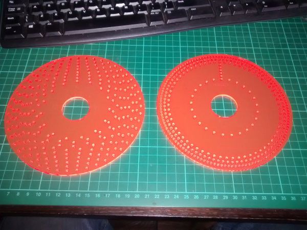

                    #183895
                    John Stevenson 1
                      @johnstevenson1
                      Here's one [ or two ] I did earlier. wink
                      The one on the right is the "get Adam out the mire " plate and has 127, 89, 63 and 25 holes on it to cover the 89 he needs and others that are not on standard plates.
                      The one on the left id the Elliot No #1 plate which Adam doesn't have, he only has the No #2 plate, so at a later date he'll have chance to make one of these up.
                      Now need to find a stamp which is harder than doing a plate blush
