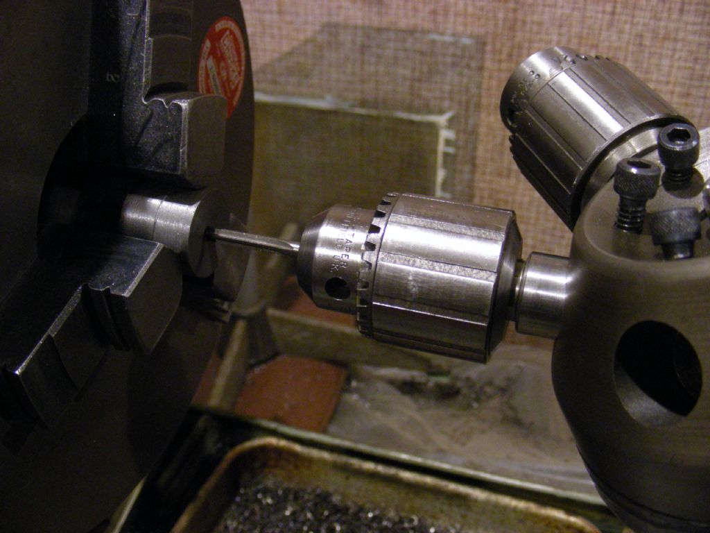

                                ega
                                  @ega
                                  Contemplating fitting a taper pin and anxious not to break the reamer, I hit upon a dodge to allow me to turn the reamer by hand:
                                  The reamer is held in a drill chuck in the tailstock turret with the chuck shank free to rotate in its seat; the reamer can then be safely turned by hand, advancing the tailstock ram as necessary.
                                  I would not do this repeatedly for fear of enlarging the seat and was careful to check that the shank was free of burrs that might score it.
                                  #381769
                                  Marcus Bowman
                                    @marcusbowman28936
                                    A handy device for doing this in a more controlled, and better supported, way is to mount the chuck on a long parallel shank. Make a fitting to suit your tailstock, and drill and ream it right through to suit the shank of the chuck. That lets the chuck and shank slide while being guided. I made one for my lathe, from a blank 2MT arbor, and it gets lots of use. You could also look at the Hemingway floating reamer attachment.
                                    Marcus

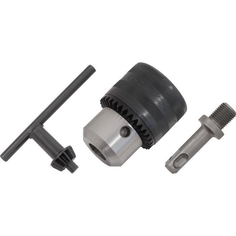

                                      Quick and dirty tap and small reamer holder – blank end arbour to fit your tailstock bored to fit the shank of an SDS drill chuck.(Nominal 10mm but may be slightly under)
                                      #381812
                                      ega
                                        @ega
                                        Marcus Bowman:
                                        Yes, if I did this often I would use the proper device that you describe; the point of my post was that broadly the same function can be achieved without any extra work being involved.
                                        Nick Clarke 3:
                                        Do you mean the kind of SDS chuck supplied for use with hammer drills? They are typically of 13mm capacity and, I would have thought, rather chunky for this delicate application.
                                        Incidentally, my SDS chuck of this type has a splined bore rather than a shank.
                                        #381996
                                        Nick Clarke 3
                                          @nickclarke3
                                          Posted by ega on 22/11/2018 10:30:00:
                                          This is the one I bought from T***station – almost 5 minutes drive from here – I said quick. Works fine.
                                          #382010
                                          ega
                                            @ega
                                            Nick Clarke 3:
                                            Thanks for the photo; I see what you mean about the shank.
