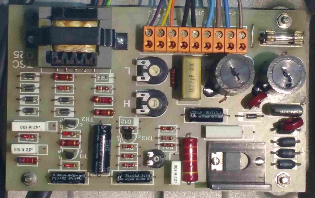

      I have an older cowells CW with 200v DC shunt wound parvalux motor and variable DC drive.
      The motor has 4 wires with separate armature and field windings.
      I guess the controller is doing PWM
      It runs OK for 10 mins then something trips in the main house fuse-box ( (either the ring-main trip or the RCD depending where in house I plug it in). If I reset the trip then it only takes another 30seconds or so to trip.
      So I guess something is getting warm and leaking current. I don't know what. Any idea how to fault find?
      I have a 40v variable DC supply which maybe I can use to test the motor? I can probably find an oscilloscope and multimeter.
      Any suggestions?

            I'd start with meggering the motor…..windings and armature….are there any RFI filters associated? They may be leaky?
            Then look at the speed controller…..in fact you could disconnect the motor altogether from the controller and substitute it with a 100 watt lamp as a load….if the trip doesnt go after a period, then it looks like earth leakage…( a much safer approach rather than lifting rhe earth wire)

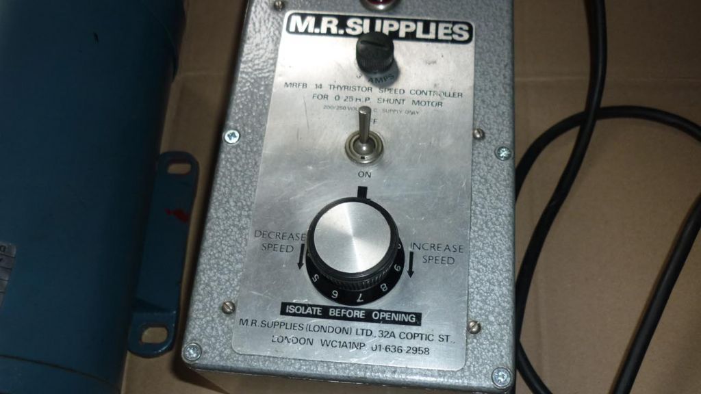

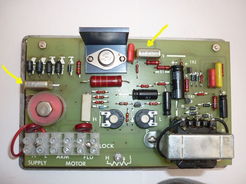

              #263867
              mark smith 20
                @marksmith20
                Hi Is it like this ? I used to have a cowell that used this type of controller , i dont know whats causing your problem with rcd tripping ,but the two paper film capacitors arrowed in the photo were the culprits on mine when the drive was playing up..

                #263873
                John Rudd
                  @johnrudd16576
                  If the unit is like above and it turns out the caps are the cause, should you replace them, ensure their replacements are X rated…(designed for connection across the mains..)

                    john fletcher 1
                      @johnfletcher1
                      If it is those two capacitors, you can snip one lead on each and try running the motor, a fully functional motor will run without them.These capacitors are fitted to Kenwood food mixers and the like and are available on ebay or your domestic appliance repairer, must be X rated.

                      mark smith 20
                        @marksmith20
                        You only seem to have one larger value capacitor (or is that another different make , middle far right?), is the capacitor made by RIFA, according the radio enthusiast forum i got help with mine from, they are reknowned for being unreliable and blowing(often with quite a bang).
                        One of mine was visibly deteriorating but i changed both and it worked fine afterwards. I think i used kemet ones possibly plastic film and rated X2 275V on the advice i was given.
                        I suppose they could be the source of the RCD problem as they are to do with noise suppression.

                          X caps are fitted across L-N or sometimes after the bridge rectifier. It's unlikely they would trip the RCD if they went leaky. On the other hand, Y caps are fitted from L and N to ground and could cause tripping. Generally when X caps fail, they will make a lot of noise and a filthy rank smell, blow their sides off and most likely blow the fuse. Evox RIFA (now part of Kemet) probably made the majority of RFI caps out there. Probably a bit of a generalisation to say they are crap, as they have made billions of them and I've not heard of any quality concerns. However, most electronic components have lifetimes and wearout mechanisms, so if it's getting on a bit you might have to forgive the odd failure.
                          As suggested, you could snip them out and the drive should still work fine but I doubt that's the issue here.
                          These drives generate a DC current in the field and a variable DC current in the armature (I think that's the right way round). It's possible the motor insulation is breaking down after all these years. If it hasn't seen much use, you might find that leaving it to dry out in a hot place (on a radiator, on a hot water cylinder, inside an old boiler) will help. If you have access to a Megger insulation tester, you could test the insulation between the windings and the frame.

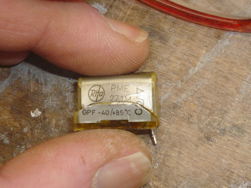

                                  mark smith 20
                                    @marksmith20
                                    Whats the hp of your motor??
                                    Heres the faulty capacitor that i removed. It didnt blow or explode with any smoke. Ive heard they are self healing but my controller worked when i replaced them.
                                    Edited By mark smith 20 on 31/10/2016 12:39:35
                                    Edited By mark smith 20 on 31/10/2016 12:41:36

                                      My keyboard has been illuminated by the glow from the bottom of my cowells for 20 mins now… so I guess the controller is not the cause. This is a shame as I think it would have been the cheaper fix.
                                      So the 200v DC shunt motor leaks to earth when it gets warm. New ones are expensive.

                                        It could be a build up of carbon dust around the brush holders. It is worth dismantling the motor to find out.
                                                +1.
                                                Used to happen quite frequently on industrial DC spindle & servo motors when these were common. Sometimes the semiconductor fuse would blow but, more often with earlier drives, the thyristors would often blow to protect the fuse.
                                                Before stripping the motor down, try removing all the brushes, take the motor outside & blow through the brush holders with dry compressed air. This frequently ejects the build up of dust (hence the "take it outside" bit !) – replace the brushes & you are good to go. Couldn't do this with spindle motors with external blowers though – usually a build-up of coolant residues would cause the brush dust the adhere to the brush holders & required the use of solvents to wash out the conductive gunk. Most of this type of motor had removable access plates at the brush gear end, so access was not usually too bad. It was usual to find bright "splash" marks on the brass brusholders where the tracking had taken place.

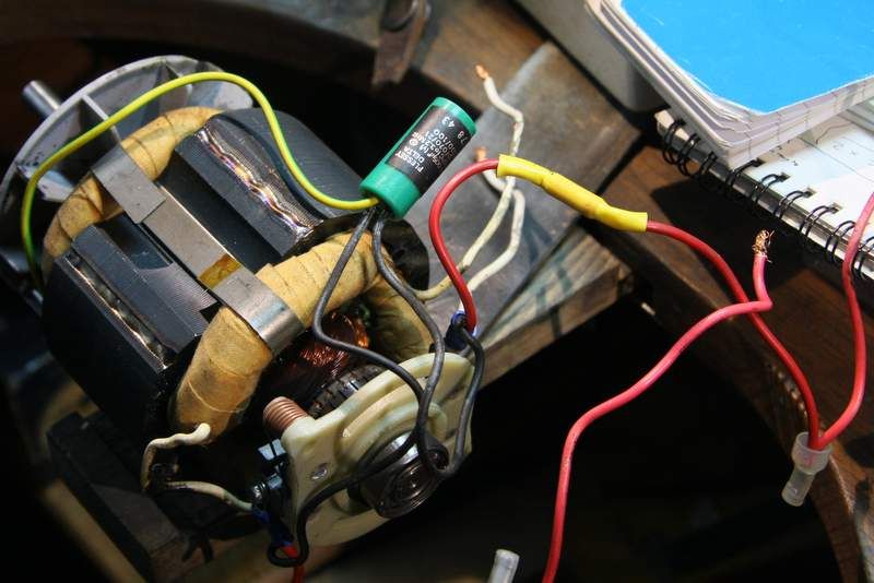

                                                jaCK Hobson
                                                  @jackhobson50760
                                                  Ha! I've been fooled by the double grub screw or long grub screw into recess before! Not this time.
                                                  In bits now. The brushes are in very good condition and it is really clean in there. Dates from 1978 but not a huge amount of use

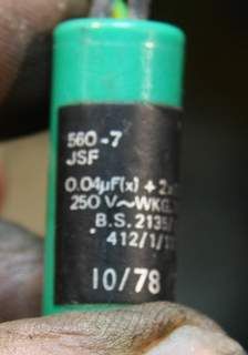

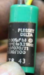

                                                  It does have a supressor so maybe I will try a new one:
                                                  Can somene point me to a suitable replacement?

                                                  #264726
                                                    Shouldn't be difficult, for example Maplins sell a similar delta suppressor for £3.49
                                                    #264728
                                                    John Rudd
                                                      @johnrudd16576
                                                      ..and before condemning the motor, try running it on the speed controller…..just in case it is the filter caps that are the culprits….more likely the one going from Live to earth…..
