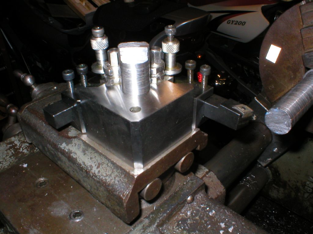

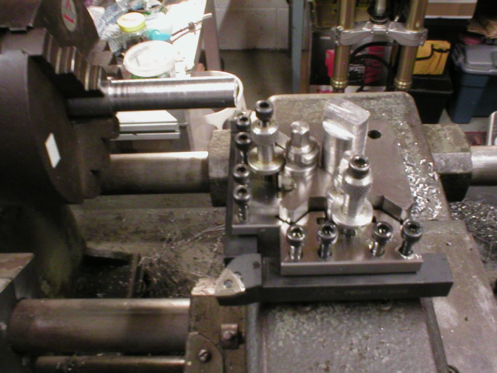

                                      Here are two photos of the finished QCTP. The securing nut is like most of my learning efforts, functional but not pretty. I intend to make one that matches the L shaped wrench that came with the QCTP but for that I will need some way of accurately measuring angles on the mill to make a hexagonal stud. So I guess my next purchase will be some sort of vice with a dividing potential

                                        Hi John, Terry has summed it up so well.

                                                    First impressions of the QCTP are good. Being able to adjust the height of the cutting point of the tool without shimming makes lining it up with the centre of the lathe a doddle. Only problem is that my 12mm carbide tipped tools appear to be too large to get lined up with the lathe centre line. Need to investigate further or else mill off a little of the underside of each tool to enjoy the full range of adjustment.

                                                      Just a small point, but from the pictures your tools appear to have a rather large overhang from the toolpost.   You should aim to get the minimum possible sticking out i.e. unsupported, as excess can lead to vibration and chatter and hence poor surface finish.
                                                      Sometimes it is necessary to reach difficult cuts but generally try to keep it to a minimum.
                                                      I never really had a problem with shimming.  With a good stock of precut shims (sheet steel, tin-plate from old cigar tins, shim stock, even old credit card plastic etc.) it’s quite quick and easy.  I learnt from the Late G H Thomas (you should read his books, most libraries have them, his style is a bit long winded but his information and advice is priceless)  that once a tool is correctly shimmed you just need to keep the shims with that tool until you need to grind it.  With insert carbide tools that’s even easier as the tool height never changes,, nor does the height of the work, and there are less screws and knobs to scar your knuckles – don’t ask how I know.
                                                      Great stuff though.
