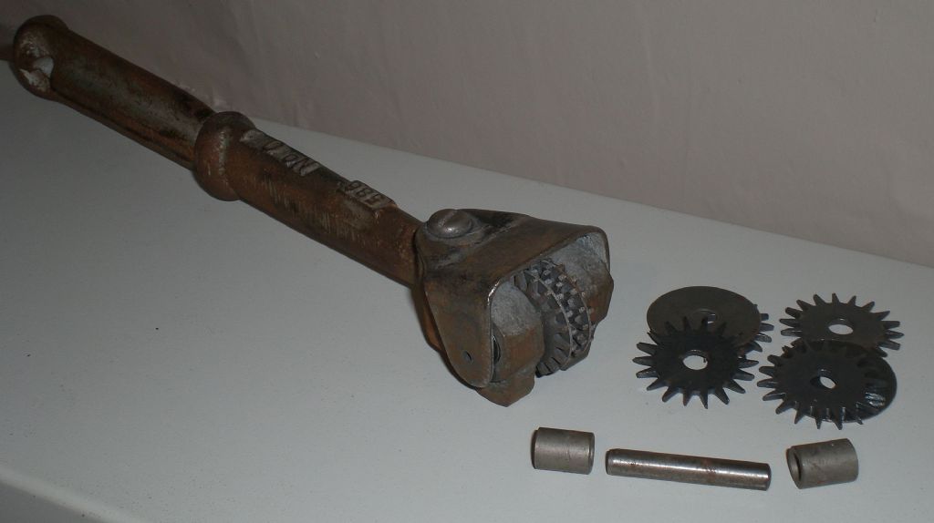

                    To expose new grit on a stone wheel you should a Star dresser which has a multi head full of spiked metal wheels. These dig into the matrix and remove the bond and exposes new grit.
                    Using a diamond dresser on the wheel only smooths the surface and trues its shape and in fact lessens its ability to cut.

                        for those who don’t know or haven’t seen a star dresser for stone wheels that Clive has discribed, here is a photo of one with a new set of replacement star wheels seperation discs, pin and bushes.
                        Regards Nick.
