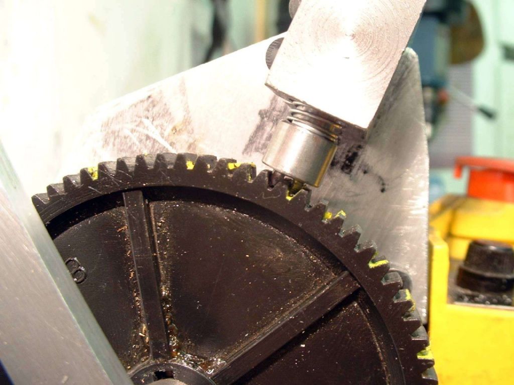

            It's easy to fit change gears to a plug in the back of the mandrel, I did this for my mini lathe, combined with a mandrel handle.
            You can also make a detent in the form of a forked peg, which is what I did. One way it fits between teeth, the other it fits over a tooth.

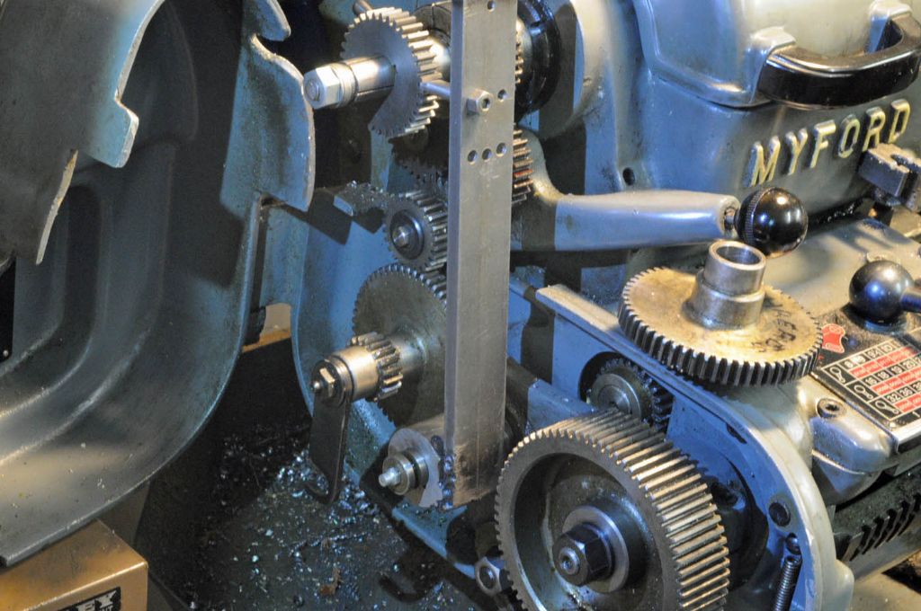

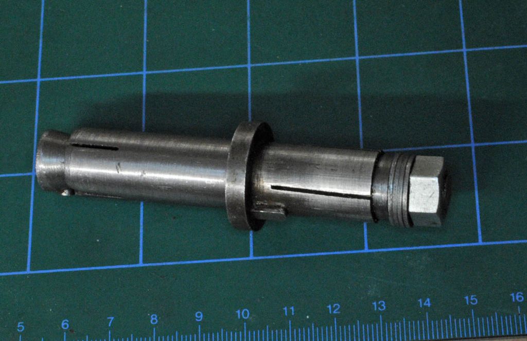

                      Roderick Jenkins
                        @roderickjenkins93242
                        In which case Dave, perhaps these pics will give some ideas:
                        Cheers,
                        Rod
