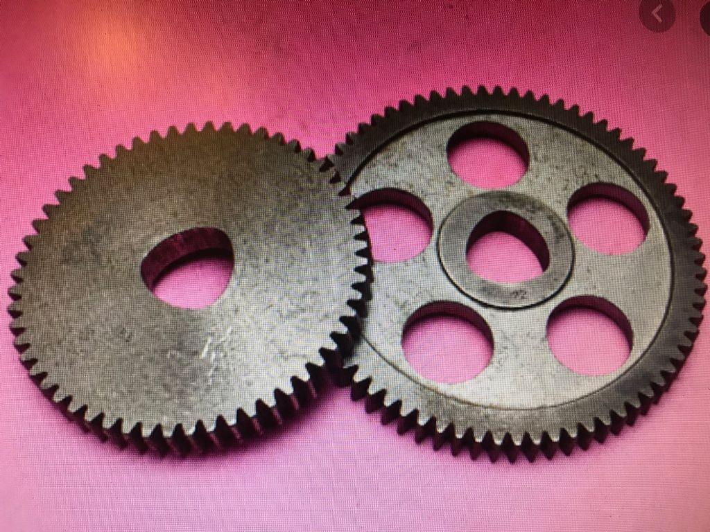

      I am wondering how one would go about cutting a tri-lobe bore in change gears (Schaublin type), using a non-CNC mill with DRO. Any theories on this, or even practical experience? I attach a photo of what i am talking about.

          tri-lobe bore

            If you have access to a rotary table, you could drill the three corner holes first, then mount the gears off centre on the rotary table and remove the waste with three arc cuts. If you made a sub-table for the rot tab with two pins close fitted to two corner hole centres the gears could be positioned and clamped located at the pins, pins removed, cuts made. Careful measurement and planning before any cuts would be the order of the day I think.

              The OEM gears were probably broached, the cost of the broach would be spread over a lot of gears and would save a lot of messing around with other methods.

                You need to cut three circular arcs with the end / intersection points defined by the centre of the milling cutter being at the vertexes of an equilateral triangle.
                Theoretically its just a matter of sorting out the right size milling cutter and the necessary offset of the gear relative to the rotary table centre and cutting three arcs.
                In practice jigging isn't going to be simple for the second and third sides as you are cutting away at the gear centre bore and cannot use it for a reference. Most obvious way is to drill three suitable holes in the gear blanks to fit three pins in equilateral triangle formation on the jig.
                Jeffs suggestion of creating the three corner holes first and using internal pins may not work as you will be cutting into the pins at the ends of the arcs. $64,000 question is how much of the locating pin gets cut away. If you have more than half the pin left it should be sturdy enough for location.  Or maybe pull the pins after clamping the gear in place. If done carefully things ought to stay put.
                Sorting out the appropriate size of milling cutter looks to be a serious exercise in CAD geometry. Easy enough to design in the first place but much harder to reverse engineer. I suspect the originals were broached so no guarantee that the tips of the figure can be cut with a standard size end mill. Errors due to using the wrong size end mill will appear on the tips so it ought to be possible to arrange an acceptable tolerance.
                Fundamentally its the same challenge as machining the housing for a Wankel engine. I believe folk have successfully modeled such so perhaps there are build threads or frum chats covering the process.

                            The Schaublin gear centre is not a proprietary item. It is made to a DIN standard (DIN 32711).
                            Put 'P3 polygon shaft' into Google and enjoy…
                            See: https://autodesk.i.lithium.com/t5/image/serverpage/image-id/481760iD30BCACD1A778304/image-size/large?v=1.0&px=999
                            For example, https://www.powertransmissions.co.uk/project/p3g-p4c-polygon-profiles-splined-profile-muff-couplings/
                            There is nothing complicated about it that requires CNC mapping. It is just three pairs of arcs.
                            Easily done on a rotary table with a fixture, some travel stops and a cutter of any diameter less than that of the smaller arc.

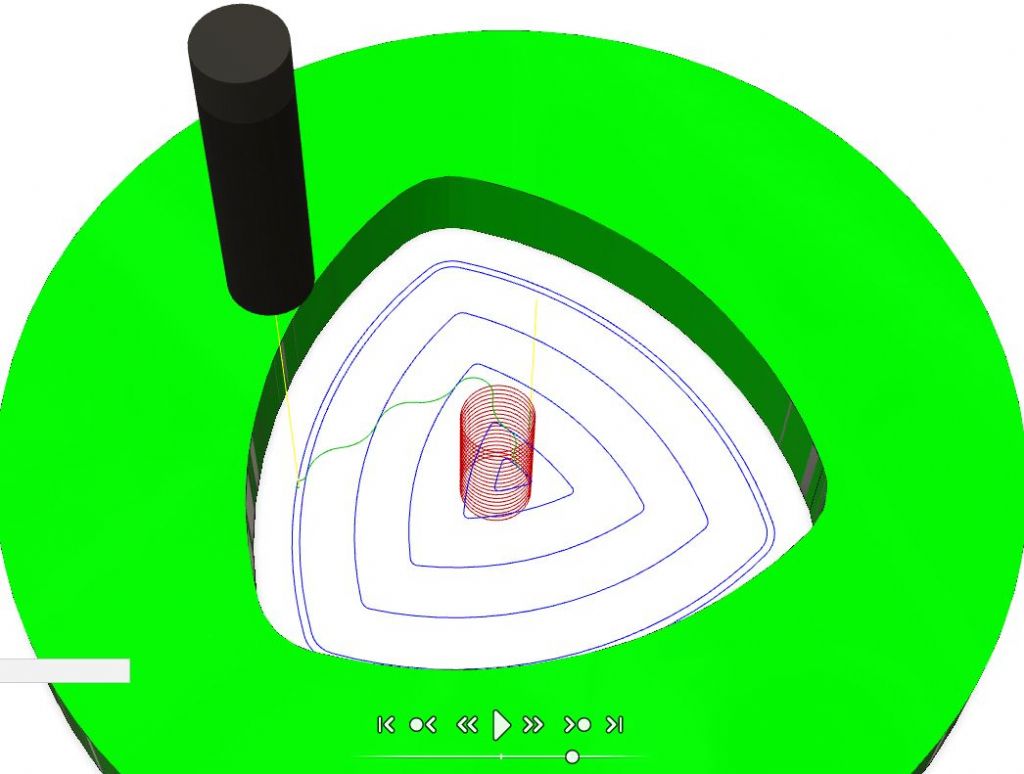

                                    If using CNC you could and would use any cutter less than the diameter of the corners it would simply work out a path to follow them as arcs just like the three larger radius ones. In fact far more preferable to use a cutter smaller than any internal radii as it saves increasing cutter engagement which can lead to chatter.

                                          For Clive, Blue lines show the path that the axis of the cutter follows, you can see that it is rounded as the tool follows the smaller corner radii by the offset which is half cutter dia, red is where it follows a helical path to bore down through the work before working it's way outwards in roughing cuts then a smaller stepover for a finish pass.
                                          Edited By JasonB on 16/06/2020 08:12:38
