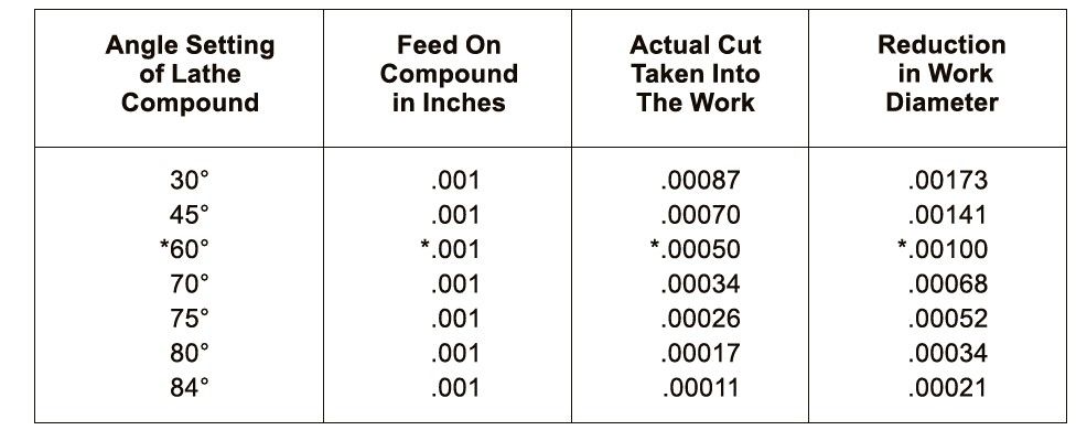

                                    Mart ,could you explain to me how you achieve such a fine depth of cut.I can't get at a guess less less than .125mm on my Myford large bore and half a th on my old Myford.I don't have digital read outs so I assume you do and that is how you do it.
                                    Frank
                                    #506053
                                    Nick Hughes
                                      @nickhughes97026
                                      Hi Frank,
                                      You set the compound/top slide at a shallow angle and use that to apply the cut depth:-
                                      Nick

                                          Just like to state (in case it is not obvious) that the angle marking for the compound on some lathes is not always as you may expect. The normal position for the compound for most people is parallel to the spindle axis and this is the 90° position for the table above. So the 84° position is not far off parallel to the spindle axis. The usual place that this issue shows up is when beginners try to set the compound to 29.5° to cut a 60° thread form and have problems because they have set up at 90-29.5 ie 60.5°.
                                          Martin C

                                              Hi Nick,
                                              That is something I will use in future, thank you for the chart.
                                              Frank

                                                    I have my compound set to about 5.75degs which gives you a 10 to 1 ratio on long travel to axial so you have predictable tenths. Credit to GHT
                                                    #506077
                                                    Emgee
                                                      @emgee
                                                      Posted by bernard towers on 08/11/2020 18:49:44:
                                                      I too have used this method when grinding from the toolpost, but you also have to reduce the Z axis length of travel if turning/boring/grinding up to a shoulder.
                                                      Emgee
