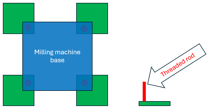

                How about if I use 4 plates on every corner. I could weld a threaded rod to each plate. And the rod will go into each hole. A 10mm thick plate would be enough? The only thing I don’t like is that the rod to plate welding should be very good. Not my specialty.

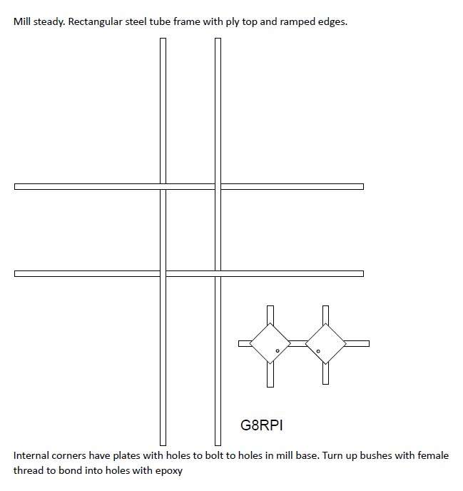

                  Quick sketch of my scheme. Not joint positions so each tipping direction has one un-jointed lenth of tube across base of mill.
                  mill steady
                  Robert.
                    Over-complicated, ineffective and needs good welding.
                    The mill will not be likely to tip fore and aft, only side to side. Channel will allow a much longer extension so much less likely to tip than small plates. The channel will also be much stiffer than plate. The channel only needs a nut tack welded in place, so quality of weld doesn’t matter. Using channel with a nut means the mill only has to be raised by the height of the channel, say an inch or two. With a plate and welded stud the mill needs to be raised the height of stud, which will be the height of the base plus height of nut and washer. The mill is far more likely to tip over when fitting the plates, which would be ironic.
                    Andrew

                        Yes, that would work. It’s just that I was thinking of some plates instead of tubes because they are not that tall and there are less chances of stumbling into them.

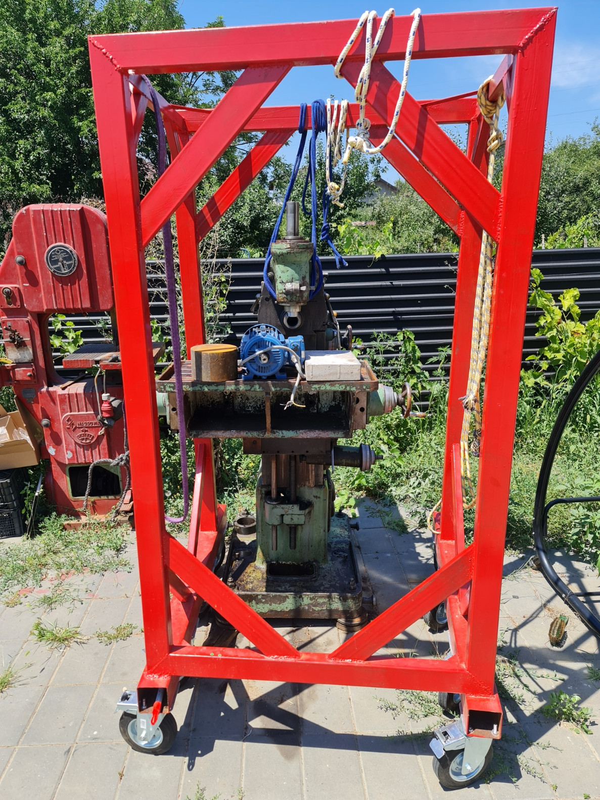

                        I’m afraid also that the mill will tip in front. This is the other identical mill I have. With a heavy item on the table and the Y axis all the way over the table I would not be too relaxed in front of it. Otherwise indeed it would be a simpler solution.
                        Here you can see how much the center of mass is in front of the machine. Those 4 slings were of equal length.

                              2- I like your idea of 4x blocks of thick heavy plate, not weld but drilled and tapped & glued rods to fit the base of the mill. I would just fit a full square base of determined size beneath it, and deal with it not to rock in any way, depending if you want to move it around or not, if not moving around a filling material can be fond and wait to settle before use(Weeks-?).

                                You could use plates as you suggest, but 12mm or better 16mm thick, then rather than trying to weld studs to it, which mean lifting the mill that much further, drill and tap M12 or M16 holes in them to take studs.
                                Make the studs of correct thread length, or use stock studding but put a dot of weld on it, to prevent it winding down into the wooden floor.
                                However, such plates would need be very wide to remove the tipping hazard.  So really, channels or square-section tubes projecting away to the sides of the machine are the better option, but do consider these may present trip hazards. You could join their ends with cross-members to form a rectangular frame, which will be better and safer. Since their joints are taking very little load the welds don’t need be to shipbuilding standards, though you could use angles and bolted joints instead.

                                              I’m afraid I worried for nothing. I put some 70kg on the other similar mill that stays outside. Then I moved the head in front all the way. I brought also the crane just in case. The machine is rock solid. No matter how hard I push it.
                                              I went back to the garage and I realized why that mill doesn’t feel so stable. It sits on a lot of wood, while the one from outside is on a harder surface. It has also some round plates on every corner that I’m going to put to the one inside. But the harder surface matters most. So … problem solved.
                                              On SillyOldDuffer Said:
                                              He hasn’t told us what size of work he intends doing on the mill.   Unlikely it will topple if small jobs only are centred on the table and the table and head aren’t traversed far.    But this is a serious bit of kit capable of machining large objects!  Presumably Sonic bought it for milling something big and heavy like an engine block,  and using it for that without improving stability would be foolhardy.   Everything I do can be lifted on and off my mill by an elderly weakling.   Sonic’s beast is more into Cutting Edge Australia territory, where everything is lifted with a yard crane, forklift truck or overhead gantry.
                                              I plan to use the mill for small things. Nothing heavier than 10kg max. I bought such a large machine because it think is cool to have one and to fix it. And it was scrap metal price. And I have enough space for it. Ok, I end up with two … 🙂

                                                This is good Risk Assessment stuff:
                                                • A potential risk, toppling, is identfied
                                                • Advice is taken
                                                • The free-standing mill, supported safely by a crane, is tested with an 80kg load on a fully extended table and found to be stable
                                                • In practice, the mill is to be loaded no more than 10kg, an 8x safety factor.
                                                Hurrah!
