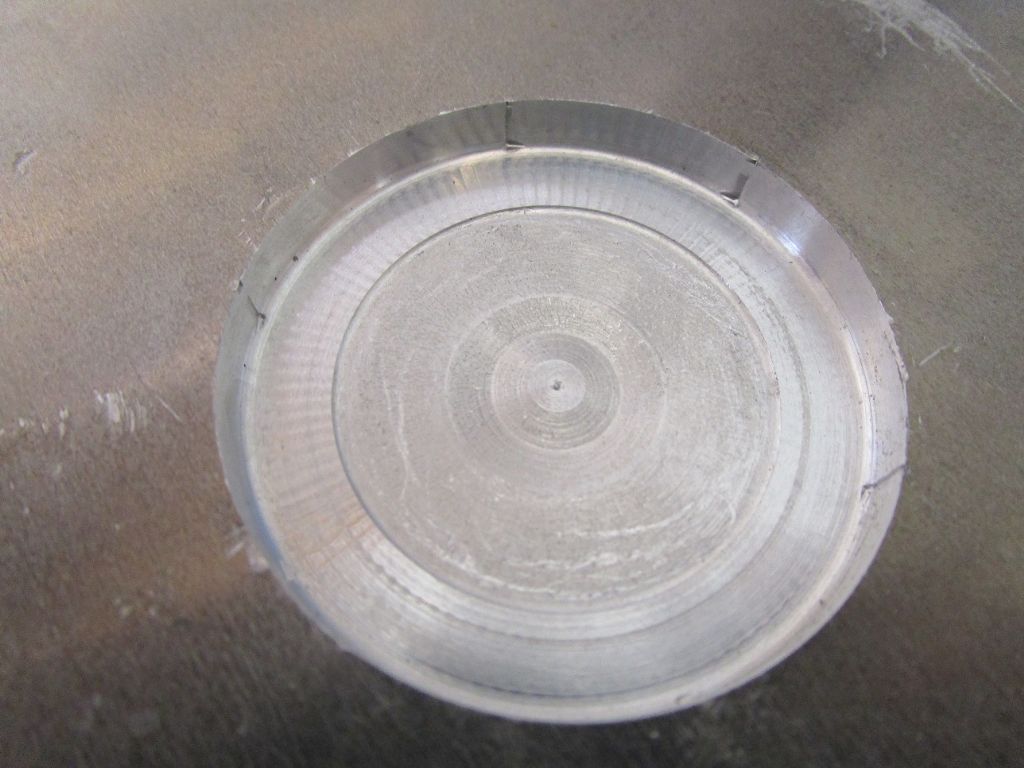

                Actually Chris the main reason your jaws can be reversed is so you can grip the OUTSIDE of larger items not so that the full depth jaws are holding the inside of tube.
                #486019
                Chris TickTock
                  @christicktock
                  Posted by JasonB on 16/07/2020 13:02:09:
                  Very helpful posts thanks . The reason why I ask is looking at this flat disk of aluminium photographed here I have it is 25mm thick with a recess on one side  I presume that was used to cut it?? To me it looks a dangerous practice, albeit you could use the tail stock against it.
