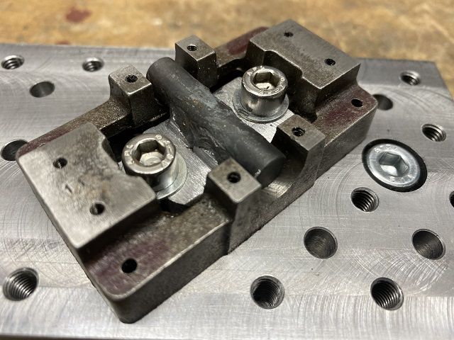

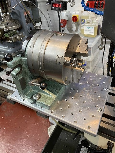

                                              Having read this thread through, I am just wondering what comments I might get regarding issues I might experience, if any, whilst machining the Sole Plate for a Stuart10v on the fixture plate I have just made.
                                              I have just finished making this fixture plate to be able to hold smaller more awkward bits in my large vice.
                                              I am only intending to take off a couple of thou or so to square up (level) the various mounting points. I am intending to run a face-mill lightly over the surface to do this. The previous owned had filed them but not very square. The sole plate is held down by metal bracket which has the bar (located in the bearing recesses) welded to it.
                                              The biggest problem I have with the engine is that he had machined the bearing bores so badly that it needed a 24thou shim under both sides of one of the bearing block to free the crank up. When I got it it only spun the crank if the bearing hold down bolts were loose. The recesses for the bearings are level with one another.
                                              Colin

                                              Nigel Graham 2
                                                @nigelgraham2
                                                I must admit I would put a block below the stepped-block so all the teeth are engaged, but as I have not seen the video (YouTube demands an "account" now), I accept the defences put up for what had actually been done after the operation in the still.
                                                What I'd not considered, since it is flat steel on flat cast-iron, is padding between table and block. I do though, ensure no swarf trapped in the joint as that would indeed damage one or both faces.
                                                #523152
                                                Nigel Graham 2
                                                  @nigelgraham2
                                                  Colin –
                                                  My comment is that what you have there is a good way to approach the task, and I like the fixture-plate, but be careful not to indent the journal surfaces with the bar. It shouldn't do, but it is a point I'd consider.
                                                  What I'd do though, is put larger counter-bored holes appropriately in the fixture-plate to give the option of securing it directly to the mill table. (I assume that cap-screw holds a tenon for gripping in the vice?)
                                                  It's often worth when making jigs and fixtures considering such options to increase their capabilities from the start, but without going so far you spend more time and material making the jigs than making the bits the jigs are for making….
                                                  #523160
                                                  Colin Heseltine
                                                    @colinheseltine48622
                                                    Nigel,
                                                    The plate is dowelled to the tenon in the vice. As it was all machined whilst assembled I am loathe to split it. I think if I need another small one I will make one. I intend making a much smaller pone for the Cowells mill.
                                                    I have in fact just recently made a very large fixture plate for the mill. It is dual purpose, in that it is used to hold the big indexer (200mm chuck) which is too wide for the table slots. It has rows of 10mm tapped holes and 8mm reamed holes for dowel pins. The indexer is around 85Kg's and the fixture plate is at least another 6kg if not more. Luckily the large piece of tooling plate came FOC, otherwise it would have cost me over £100.
