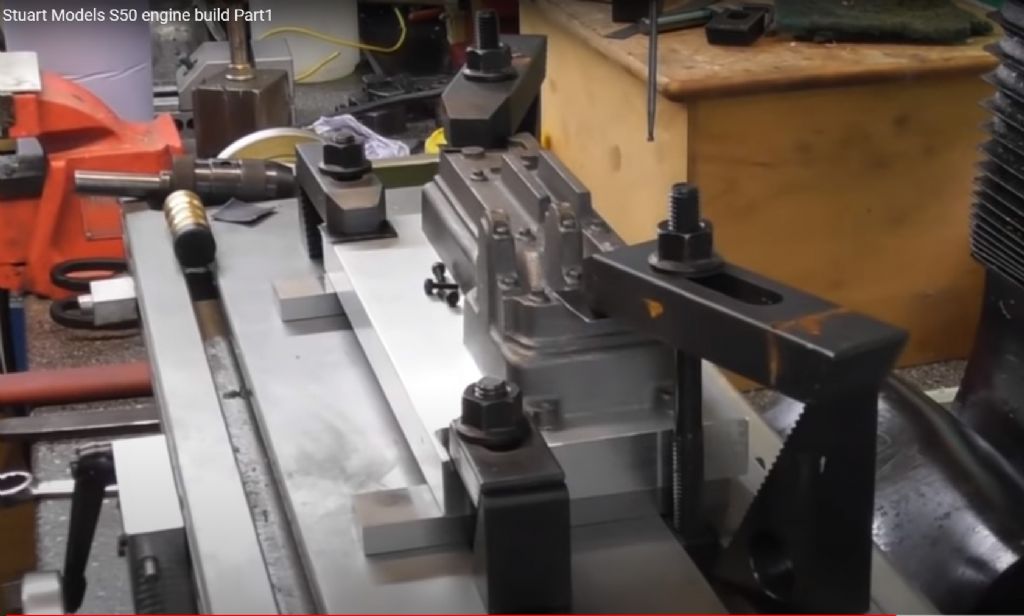

        Ramon Wilson
          @ramonwilson3
          Just read through this thread for the first time – some interesting comments but as a long time machinist….
          The image shows right and wrong IMO – clamp to the left correctly set up – clamp to the right not so. If, as it appears to me, that the clamp is resting on the very thin edge of the packing block then if the top of the packing block is higher than the job then the packing block can rock away from the clamp very easily. It doesn't matter (in my book) whether or not the job is only a simple one with or without side forces if the clamp lets go because it is not placed as the design calls for and the job gets spoilt because of it it's a no brainer.
          It really is sensible in using the clamps shown as designed ie with some if not all of the teeth engaged or a smaller block reversed and used as conventional packing. And of course the further one is into the operations the more there is to lose.
          There should be no need for packing beneath packing to prevent damage to the table – granted I've seen some pretty disfigured tables over the years but those are always a culmination of many users who exhibit little care for the machine but if it's your own it, save an accident, heaven forbid, it should be quite unmarked and not damaged by sensible clamping.

            Posted by Ramon Wilson on 22/01/2021 23:10:32:
            If, as it appears to me, that the clamp is resting on the very thin edge of the packing block …..
            It really is sensible in using the clamps shown as designed ie with some if not all of the teeth engaged ….
            FWIW, I opened a copy of the image in PSP, played with brightness/contrast and zoomed in. It appears to me that one step of each (clamp and packing-block) is engaged.

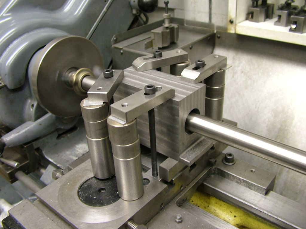

                  Absolutely plus one for that advice Derek yes – the extra grip provided by a simple sheet of paper is out of all proportion to it's simplicity.
                  Peter, The image is dark but I accept what you are saying – my thoughts still stand though – inadequate or inefficient clamping is always a very easy way to ruin a part.
                  I may have mentioned this before but it's worth repeating – in my very early days of ME I had a Stuart handpump casting (poorly) clamped to a face plate set up on a ML7. Within a millisecond of the tool touching on it left the faceplate over my left shoulder and embedded its corner into the wood surround of the door behind me. The clamps rattling and frapping whilst my brain sorted frantically how to stop the lathe!
                  IMHO most clamps – particularly the commercial sets as in the image are way to large for most home bench milling machines.
                  I use a combination of 6mm cap head screws of varying lengths for the bolts which are more than adequate for most model sized workpieces. Packing is mainly of varying lengths turned from 1" dia mild steel. These are drilled through 6.5mm and counter bored. Ideal for use on faceplate set ups when they can be used not only as packing but also as balance weights
                  That's just to show my approach – not how to teach granny I assure you smiley
                  Regards – Tug

                        Oh I don't know Bo'sun, I guess it's a fair point to comment on but can say with confidence that as cautious as I am Hopper I've not had a problem with this particular set up ie using the round packing as shown. I do sometimes bolt the packing in place if there is more than one part to do as it eases the setting up but It's not always possible to get slot, packing and clamp in line to do so. When making the diesels I used the faceplate a lot.
                        I like using this system because of it's 'size' – the bolts have far more tensile strength for what is required and the packing is easy to stack – just dropping a bolt through three pieces keeps them roughly in line. I have a minimal selection of clamps, mostly home made and the four small ones kept from my very first lathe, a Unimat which get frequent use and particularly on the rotary table.
                        Like I say – I'm not teaching granny but if it does help someone new to machining it's worth saying I guess
                        Regards – Tug

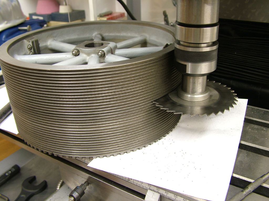

                                  Well I must admit I've never considered that someone would leave a set up on paper for six weeks but I appreciate we can't all be in our workshops on a daily basis smiley
                                  Oiling it would – I would think – defeat the object of improving grip. Using paper as such is nothing new – it has been around for a long long time. It's particularly useful when clamping is a bit marginal or in a vice to improve grip on material that wont take excessive pressure – eg a gunmetal casting.
                                  Whilst the cutting forces weren't excessive I really was expecting this operation to be fraught with moving but the paper prevented it with only a central bolt holding on the lower half of the flywheel. It's never a good idea to clamp with a single bolt at any time but it was needs must on this occasion.
                                  Saw went through on one pass at depth shown, job slackened and turned and op repeated until the two halves were separated
                                  I don't claim nor ever have to be a 'teacher' but I learnt from others passing things on – to me this is a way of repaying that knowledge.
                                  No one way is ever right – but some are definitely wrong so I hope this is seen as trying to be helpful to those who don't have the vast experience that some have.

                                        I think a few folk have got the wrong end of the stick. Ade is using pieces of Alpha leather to stop marking his aluminium plate. He uses it too to not dig the clamp into a raw casting , which could fracture it. Have a look yourself. It also helps to watch the whole video & not pick bits out of it.  Building a S50 by Ade
                                        Steve.

                                                  I see nothing wrong in this setup, especially to generate 3 pages of comments!
                                                  2 clamps on the ally plate plus 2 holding the casting down onto the plate onto the bed. He's drilling a 3mm hole! If it grabs what will fail first, the clamps or the 3mm drill bit? I see no rotational forces there that would creates a catastrophic fail.
                                                  I've watched most of Ades' videos and he knows what he is doing unlike some others on youtube.
                                                  Roger
