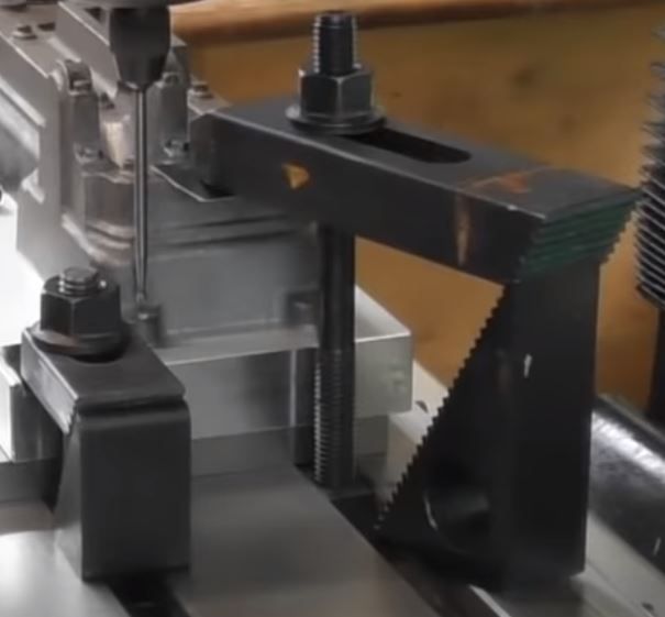

      I found this example of someone showing how to use a mill for a model engine and thought this poor clamping practice needed highlighting for any beginners who may think it is acceptable.
      The clamp is resting on the very top lip of the stepped block, the applied force is down and slightly outward due to the angle of the clamp. This is because good practice is to have the supported end of the clamp higher than the nose that is on the workpiece. The direction of the force vector is therefore both down and away from the clamped part. If you project this force vector it will be at the edge of the stepped block where it is chamfered and must be very close to being just past the support at which point everything will fall over.
      Now imagine a small additional force from the machining operation pushing this force vector beyond the support, the result is a failure of the clamping setup when machining. Not a good outcome.
      Better practice would be to put another smaller step block on the one being used and rest on that or to raise the step block on some other material so that the end of the clamp can engage with the steps much like the one to the left is being used.
      Martin C

          Pity you did not mention that this was a clamp on a very small drill operation and not a milling operation. The operator who is a very experienced machinist was drilling a pilot hole to affix the castingto a base plate for machining. The clamp was removed as soon as he had drilled the hole. No sideways forces whatsoever were involved. You should have linked to the video to allow people to make up their own minds.

            Small hole or not, why not use one of the other spare stepper blocks underneath, then the system can be used as was intended.. John
              There is no reason that the clamp cannot be used on the top step. The forces are straight down in this instance. You would have to overtighten the bolt and bend the bar before it slips off. This is a case of selective reporting of which there is way too much these days. Taken out of context it seems much more dangerous than it actually is. We have all used dodgey clamping methods we would not admit toat some time or another.

                Clamp bar looks level to me so ok to use, what I don't like or do is put the step blocks straight onto my precious ground table, in industry & now at home I use surface ground 6 mm hardened steel plates to spread the clamping load, just a little foible of minewink
                  Tony
                  I agree Tony. I use strips of aluminium under clamps to save the bed.

                    Ahhh, the road to hell and all that. At least the clamping bolt is at the correct end of the clamp slot. Pulled off another popular forum years ago due to lack of safety considerations and the "BUT" excuse to justify their stupidity. One a long qualified "Machinist" showing a milling cutter mounted in a drill chuck, and a Phoenix who after a decade still hasn't learned how to clamp safely but is hacknolegged as a resident ex-spurt.
                    The use of stepped packing blocks would have been luxury had we not had to chase round finding suitable bits of packing in my industrial apprenticeship and sorry Oldiron, the fact the poster is "a very experienced machinist" does not excuse a potentially unsafe setup.
                    Sadly, when a photo is posted on t'internet, there is no discrimination for it to decide whether the viewer is knowledgeable or a dobbin waiting for an accident to happen.

                      Was this demonstration supposed to be a means of “teaching beginners” (like recently came up in a thread?).
                      It does appear that one step on the clamps might have been in use. But seeing that, one might wonder why there are seven(?) steps provided? One might wonder why they provide so many steps? Beginners might not wonder at all?

                        Without the back story who is say whether the setup is bad or not. My gripe is that the OP goes on about milling side forces etc etc when it has absolutly no relation to the setup. That is why the back story is important.
                        As I said just another fake news story.

                          No claim to teaching at all as far as I can see. Just a "this how I did it video" . I have not seen any hobby machinist video's that says "this is how youi must do it". In fact many point out that they do not know it all but it seems some on here profess to know how everything should be done. The back story should have been shown to put this into context.

                                  Oldiron, I said machining forces not milling forces.
                                  Any setup where the clamp can rotate the step block without the clamp being raised is a poor setup. By clamping on the steps further down the step block any rotation about the heel of the step block will try to push the clamp upwards, this is resisted by the clamp bolt. The top lip is not a good place to use on its own to support the clamp because it minimises this lifting of the clamp. The operation in the video was not brought up because in the end it is irrelevant, the point is this is an example of poor clamping practice that should always be avoided so that it is not used in machining where larger loads are applied to the workpiece.
                                  I think we should always promote best practice.

                                    Poor old ADE. I watch his video's & as already stated he took that off once he had fixed to the alloy plate.

                                          I hope I would not be tempted to publish a photo like that. It would have not taken much time to pack out the clamps so the serrations were in use.
