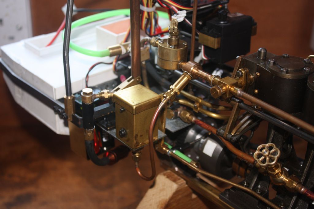

      Hi all.
      Is there a correct amount of steam oil and can you have to much?
      On my steam plant the oil tank empties in about 35 to 45 minutes, the reason for asking is because i'm getting a lot of cream coloured sludge from the oil trap.

          Hi AG! ,
          There is no specific rule about how much oil to use but generally model engines are very much over oiled .
          It's really down to finding a flow rate by trial and error that keeps a specific engine happy .
          Generally if piston rod , valve rod and exit from exhaust are all just a little bit oily then all is well .
          Full size Great Western big engines were supplied with just one small pea sized drop of oil per minute per cylinder . Scale that down and you get practically nothing for a model engine .
          Very severe over oiling could cause hydraulic lock in full size engines but this is not likely to be a problem encoutered in a small engine .
          You might like to follow GW practice and experimentally at least fit a sight glass in the oil supply line .

            As rule for the lubricator in modelsteam engine has 25-30 revolution for each pump stroke. If too much oil, increase revolution for each pump stroke.

              Thanks for replies.
              Yes i do get alot of oil on the valve and piston rod exits so i'll turn up some different cranks with a shorter throw and trial them for a couple of test runs. Are there any signs i should look out for of under oiling the engine or if it seizes i gone to far.
