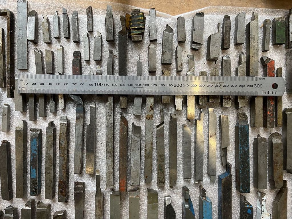

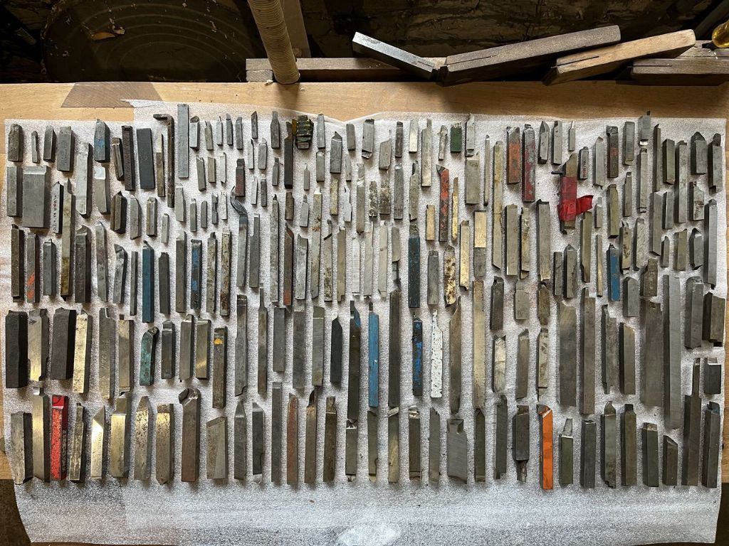

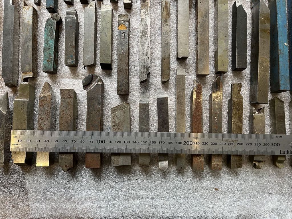

      Hi All,
      I hope this isn't inappropriate or in the wrong group but I have lots of tooling that came with my ML7 lathe that I don't think I'll ever need so I have decided to sell them to help raise funds for a small milling machine. The problem is that I have absolutely no idea of their value and I was hoping to gauge opinion as to how much I should ask for them. There are over 200 pieces and they weigh somewhere between 25 and 30kg at a guess. They vary considerably in size (some of which don't even come close to fitting in the ML7's tool holder!) and many tools have been ground on both ends with profiles for specific jobs.
      I'd be most grateful for any help.
      Paul.
