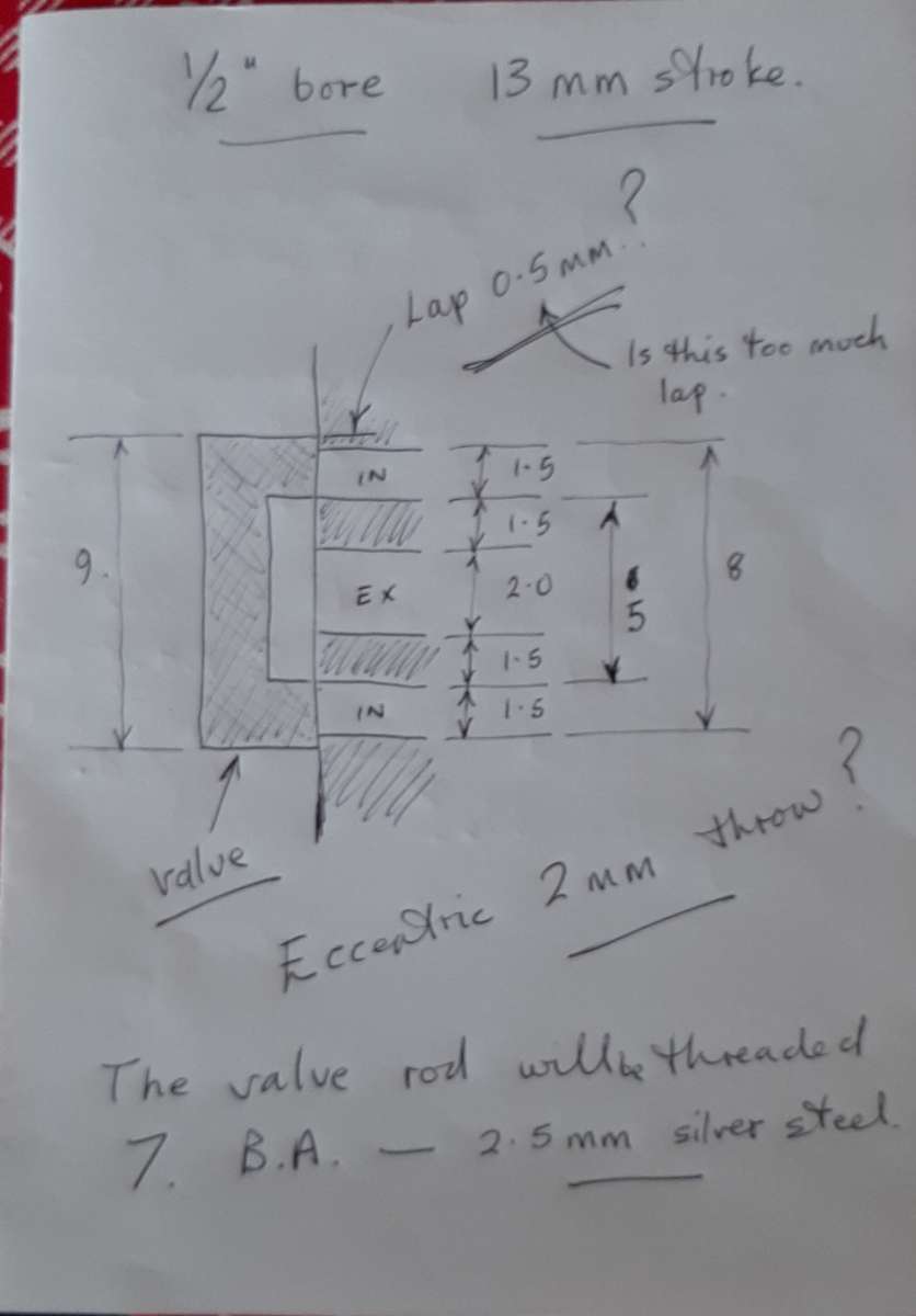

      I’m currently making a small slide valve, own design, 1/2″ bore, 13mm stroke.
      The drawing here is a possible slide valve arrangement.
      Is the lap too much? Any advice on calculating the lap would be welcome.
      The valve rod will be 2.5mm dia and threaded 7 b.a.
      Any thoughts gents?20250103_150016

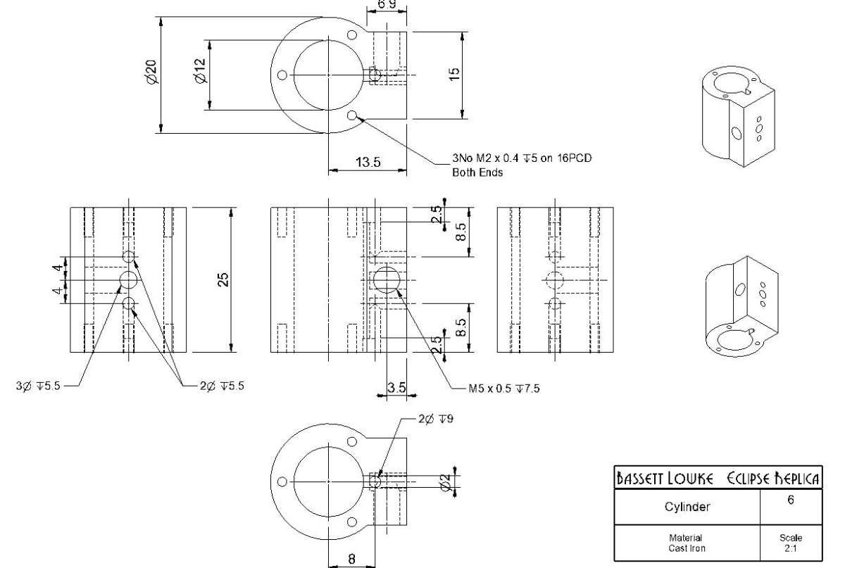

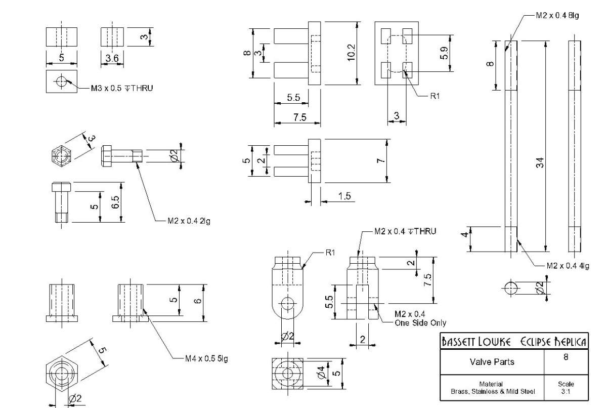

        On my 12mm bore ones I tend to go for a bit less, typically 0.1mm but I do run on air and have round ports rather than slots so you don’t get quite such a large area of port uncovered at the beginning of the valves movement.
        I’d make it as you have it an dif need be take a little off but it will probably be fine.
        Typical one her, the width over the two holes will be 10mm and my valve is 10.2mm, same 2mm throw on the eccentric
        BL Cylinder
        BL Valve

          If someone else would care to review my calculations… It’s been a while since I examined a valve’s dimensions.
          Mid-gear valve travel = 2(Lap + lead), but your design seems to have no lead, which is fine here.
          I.e. the valve is only just on the point of opening to admit steam when it starts its return journey.
          So Full-gear VT = 2(lap + port opening). I’m guessing this engine will work on a fixed cut-off, as typical for engines used for driving stationary plant in factories and the like. (They used governors to keep the speed constant, where necessary.)
          The ports don’t normally open fully to admission, only to exhaust.
          Full VT = 4mm, neglecting any slight angularity effect of the eccentric rod.
          So for each end, L + P = 2mm, giving the full  1.5mm port opening and a very late cut-off with 0.5mm lap.
          I’d suggest more lap, not less. 1 mm lap will give 50% port opening, probably enough for this engine unless you intend giving it some fairly heavy work (by its scale) to do.
          I’d be tempted to test it with a dummy valve, perhaps made from transparent acrylic, so you can also ascertain the exhaust events by turning the engine by hand with the valve chest open, but if you make the valve a bit too long you can at least trim it back.
          My club used a similar method, with a transparent valve, to prove a drawing error in a locomotive it built: there the laps so precise to drawing, were too long, making proper valve-events impossible.

            Nigel, the valve is shown at mid-travel and the position of the eccentric is not shown, so I don’t think you can deduce anything about the lead.
            If there were 1mm of lap and the 4mm stroke were retained, the ports would be opened to 1mm, or 2/3 of their width, not 1/2.
            The amount of lap can be more for running on steam, but if the engine is to run on air then it does not need much lap. Also, the higher the inlet pressure, the more lap is justified.

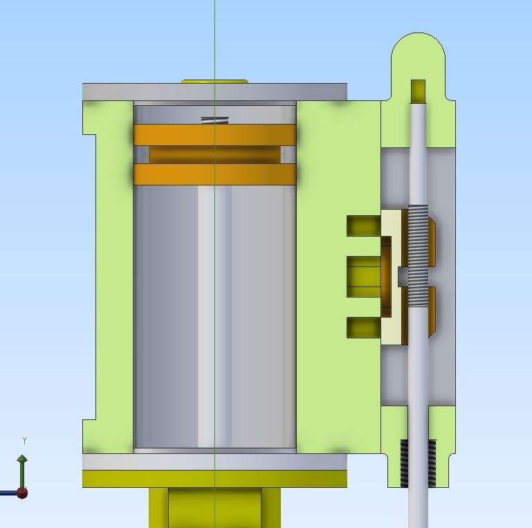

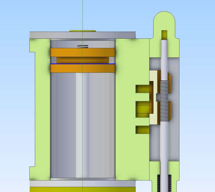

                here is another, Clarkson Vertical. Although converted to metric the proportions are the same as the original drawings.
                3mm ports and 1mm lap so that would equate to exactly the same as HW’s 1.5mm and 0.5mm.
                As for how much of the inlet is uncovered it actually has more throw at 4.5mm which would be 2.25 on HW’s engine, this takes the edge of the valve beyond the inner edge of the port.
                Runs very nicely and Mr Clarkson obviously knew what he was doing.
                Mid travel
                cv 1
                Full Travel
                cv 2
