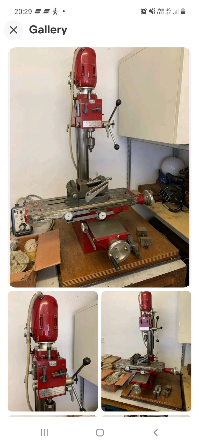

      Hi all
      Just a quick question, how much are these mills? I really like the look of them. One was up for sale on Ebay not long ago but the seller wanted £950 which seems like a lot to me. What are your thoughts?
      Best wishes
      Luke

        Trying to determine how much this Emco Mentor mill is worth

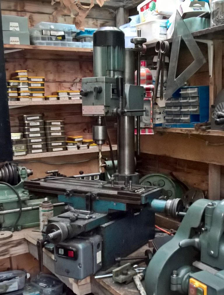

          That's very different to my Mentor mill, does it say MENTOR on the side somewhere? The Mentor mill was popular in school workshops, hence it's name

            From the looks of the pictures no I cannot see any model or make. When I searched Google for the Mentor it has some similarity to the pictures on Tony's website but also some differences dont know

              Looks to me to be a Mentor mill that has been fitted with a non-standard motor via a custom made adapter – note the Parvalux speed controller in the background. There is a comment on Tony's site about the original motors running hot & expiring early.
              Difficult to guess at prices these days, but £950 sounds optimistic to me for a machine with (most likely) zero spares backup. The Mentor pre-dates the FB2 (for which spares support seems sketchy at best ) & I have a recollection of having read that the gearing is a bit fragile, so lack of (or difficult to source, or expensive – or both ! ) spares could be an issue.
              I would want to see demonstrated that all the gears engage & run quietly – maybe pop the access panel off the gearbox for a look inside if the seller was amenable.
              The quill travel is a bit short (if I read Tony's site correctly it is 40mm, same as my FB2 clone ) & doesn't have a fine feed. From the pictures on Tony's site the Mentor also appears to lack the FB2s adjustable depth stop on the quill feed.

                  I can see the two levers for the gears are like mine and also the plate below with the speeds on, other than that it's very different. One exactly like mine with the blue/green paint finish is on Tony's site. The gears are cast iron but very noisy on mine even though there seems to be no visible wear.

                    I know that eBay seller, has been a nice bloke whenever I've dealt with him, his main business is supplying/maintaining machine tools for schools and colleges.
                    That said, there's no way that mill is worth just shy of a grand!
                    On the second hand market you could (with patience) get a decent full sized mill for that money, or as other posters have said on the new market you could have a far eastern mill of a similar size to that EMCO.
                    If you do fancy that particular mill (it wouldn't be for me, but we all have different requirements) and it re-appears on eBay I would suggest contacting the seller and asking if he's open to negotiation on the price as you've seen it's not moving.
                    The question really is "How much would that be worth to me personally?" once you know that, you know what to offer and what your walking away point is.
                    He may have locked himself into a high price by giving a good price to the school he bought it from, but otherwise I would think he'd be open to negotiation, and certainly wouldn't be offended by it.

                      Thats very rich indeed, you could buy a good used light industrial or ex school Harrison for that! The Raglans only make about 8-900 on a good day, and they are a far better machine. I have seen Bridgeports make less!!
