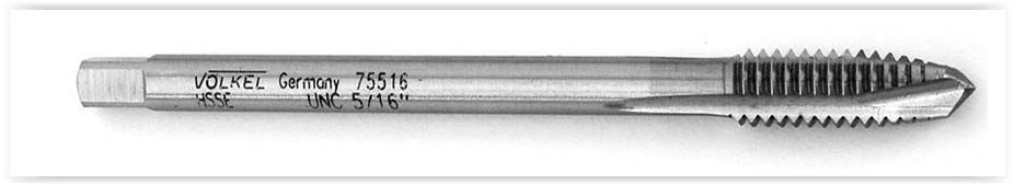

      Posted by pgrbff on 07/03/2022 07:48:20:
      What exactly is a tap plug? I understand it has a more agressive longer taper?
      A plug tap is the last in the sequence of hand taps to be used. It has a very short taper, 1 to 1.5 times the thread pitch. One might get away using only a plug tap in brass, but not in gauge plate. If only one tap can be purchased buy spiral flute taps. They are machine taps intended to blind holes, but are fine when used by hand.
      Andrew
      This is described as a machine tap. Would it work? From Germany. Euro 15 each plus 10 for shipping, to tap 4 holes. My mistake for ordering plug taps.machine tap.jpg
      #588555
      Tony Pratt 1
        @tonypratt1
        Yes that would work & looks like a decent German brand.

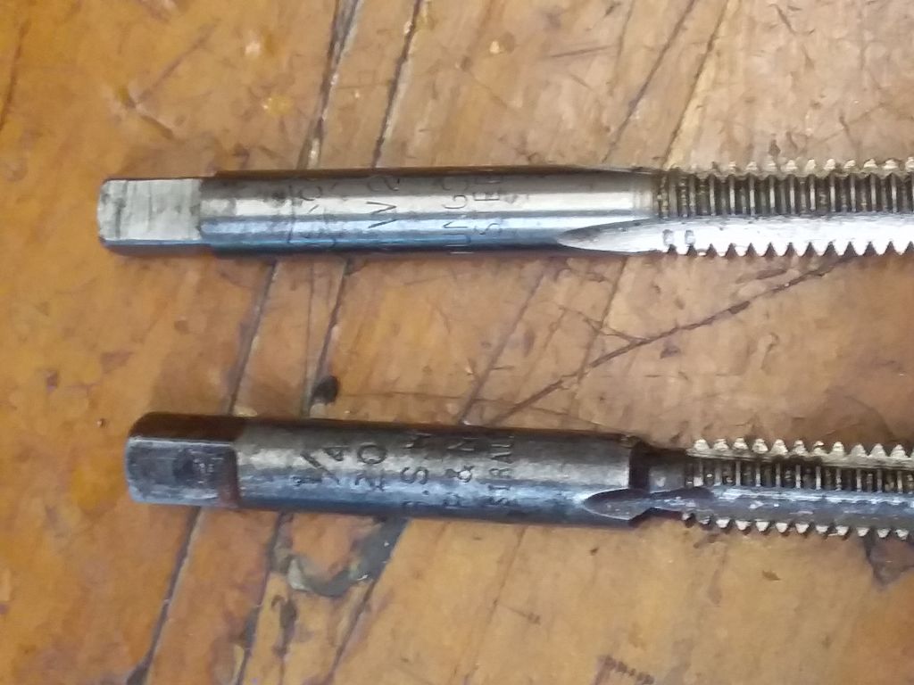

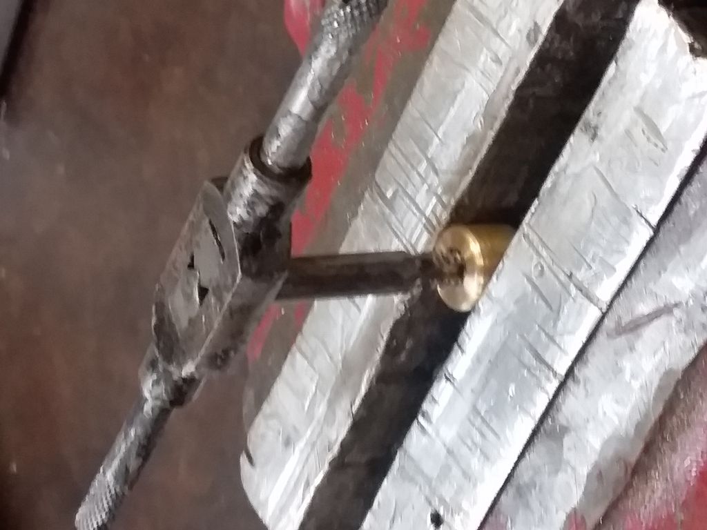

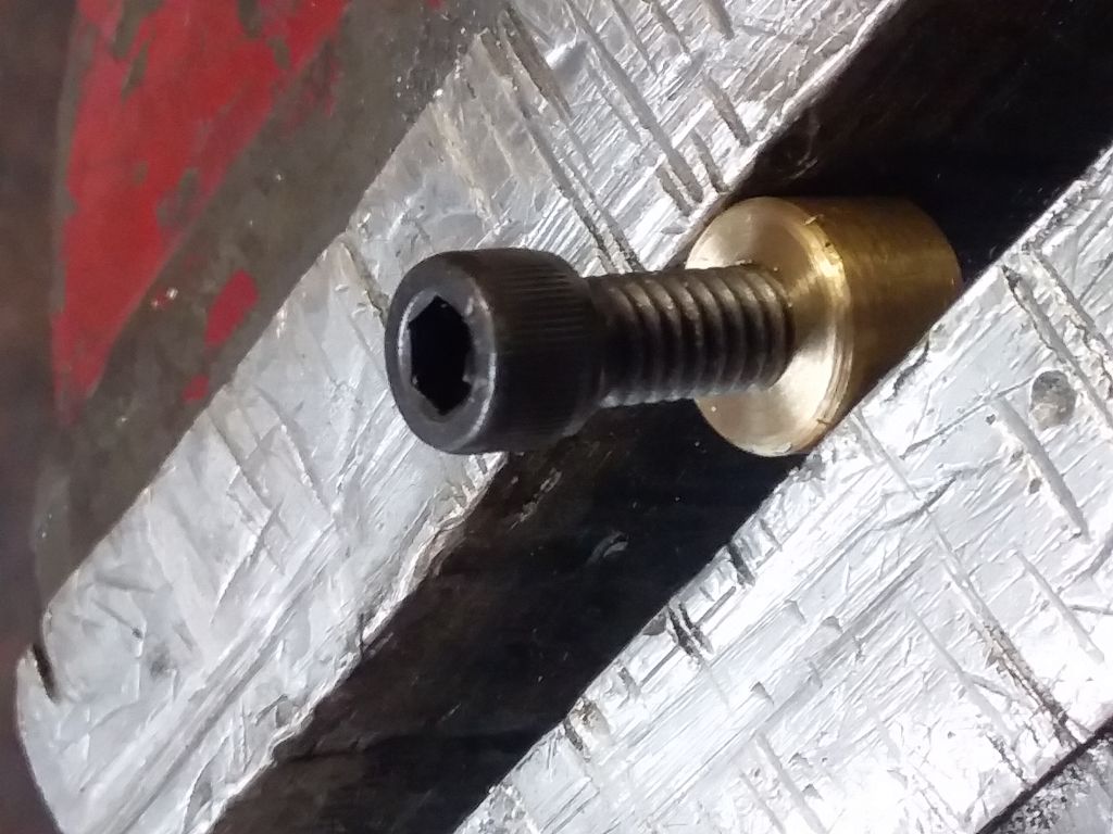

                                    Hopper
                                      @hopper
                                      I just happened to have this same job in the workshop today, which reminded me of questions raised in this thread, while making a cotter clamp for my upgraded carriage stop. (Which is another story, more of which anon.)
                                      1/4" BSW taps. 20220309_094429.jpg
                                      Tapping a 1/4" BSW thread into the brass cotter clamp 20220309_094525.jpg
                                      Screwing in a 1/4" UNC screw by hand. No binding. No slop. No dramas. It always works for me. 20220309_094605.jpg
                                      Sorry about the sideways pics. They were right way up at my end before uploading and there seems to be no facility this end to rotate them. Perhaps some kindly mod will stop by and rectify?
