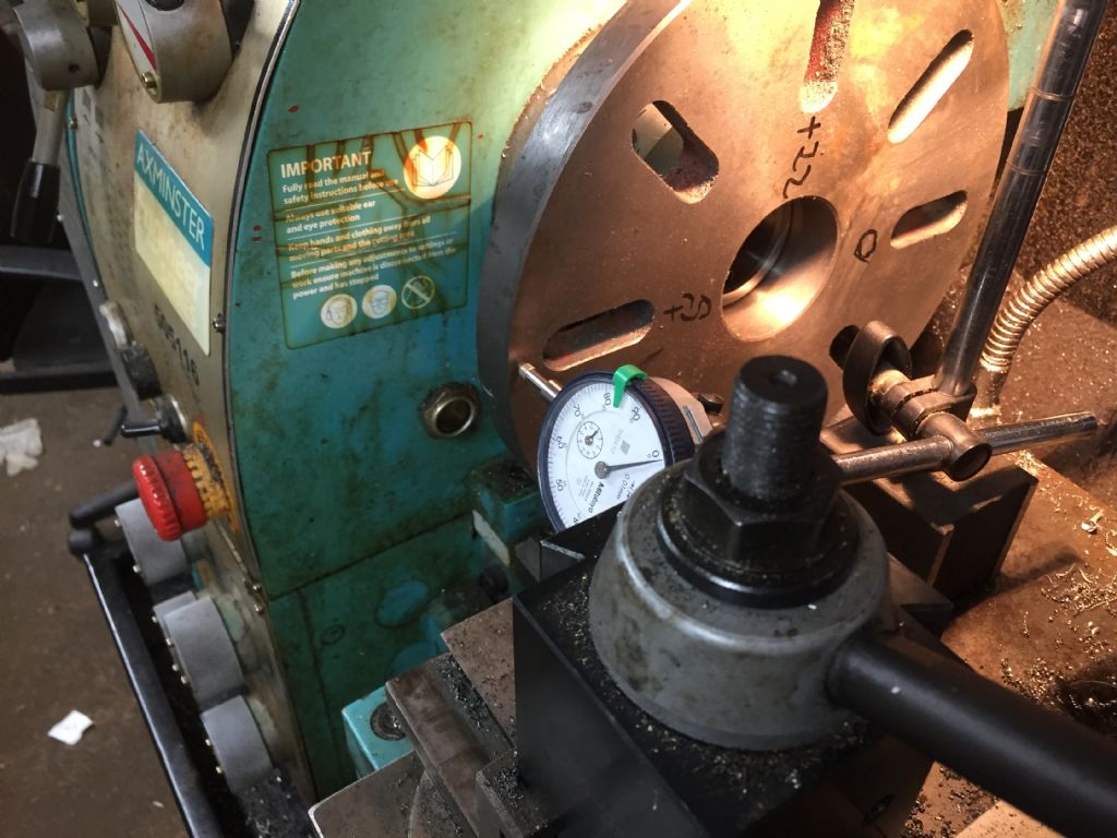

    Robin Graham
      @robingraham42208
      I recently asked about turning the ends of a round bar parallel on the lathe. At some point using the faceplate was mentioned, and I took to the idea thinking that I could skim the plate to make sure it was perpendicular to the lathe axis. Hopper said:
      'No need to skim your faceplate unless there is something measurably wrong with it. You could ruin a good plate.'
      This set me thinking. What is a good plate? So I made some measurements, rotating the spindle:
      Results (in degrees, microns) were :
      0, 0
      90, -5
      180, + 20
      270, +22
      so it's about 25 microns or a thou off over 120mm from the lathe axis.
      Coming from nowhere in this engineering thing, but enjoying every nanometre of the journey, my question is whether this is reasonable for a 'jobbing' lathe of Eastern extraction. And, of course, if it can be improved upon.
      Robin.

          Simon Williams 3
            @simonwilliams3
            "Reasonable"?
            Huh! I'd be mighty chuffed if I'd measured that.
            For "reasonable" read "pretty blooming excellent!
            Rgds Simon
            PS But (if I remember right) that wasn't Hopper's concern.  To make a flat face at right angles to the axis of rotation you need the saddle to move at right angles to the face plate.  So this is checked by passing the dial indicator across the face plate surface, rather that rotating the face plate wit the DTI stationary.
            Correct me if I'm wrong anyone?
            Edit – PS added to treat Premature Send Button Syndrome
            Edited By Simon Williams 3 on 15/08/2020 00:34:24

                Hopper
                  @hopper
                  I agree with all the above sentiments. As a beginner, on a lathe of unknown quality, with unknown wear, you will struggle to improve on the one thou runout and quite possibly make it worse. Plus there is the flatness issue, even more difficult to achieve than the runout due to wear on the carriage way surfaces and cross slide.
                  Certainly try the suggested take the faceplate off and clean the threads and register faces etc and retest again, several times. You might be surprised at the variation.
                  The layer of rust on the faceplate (or is that exaggerated in the pic?) could make that much difference alone.
                  Headstock bearing adjustment and wear could make that much difference too.
                  If you just want to have some fun, bolt a disc of metal to the faceplate and take some test cuts across it and see how it turns out. When you can get that perfect, unscrew the faceplate and clean the threads and put it back on and see if its still perfect. When it repeatedly is, you can think about facing the face plate.
                  To measure flatness, you need to either use a straight edge and feelers across the face. Or you mount a dial indicator on the cross slide and run it across the BACK half of the machined face, ie between the centre line and the REAR of the machined face. If you just run on the front half, the dial indictor just follows the same path as the tool and reads 0-0 regardless of any angle on the face. But the back half is angled the opposite way. So the true variation is half the reading over that surface. Flatness across the faceplate should be either perfectly flat ie 0-0 reading or very slightly concave, probably within a thou or so for home hobby work on an old machine. This is because a job will sit firmly on a concave surface but will rock on a convex one.
                  Personally, I would leave it as is and carry on. If you want to machine the ends of your large round bar any closer to parallel than one thou, use the suggested method of between centres and face both ends in one set up.
                  Then you need to work on your ability to measure less than one thou with a large micrometer. (Digital calipers really aren't accurate enough.)
                  Edited By Hopper on 15/08/2020 02:22:18

                      Robin,
                      May I put things into perspective from a different viewpoint ?
                      Your total indicator reading is less than 30 microns; which is a value that you may recognise … It’s the standard thickness to which petrological samples are prepared, to enable analysis with the polarizing microscope [many substances being transparent at that thickness]. It is certainly non-zero, and non-trivial in some disciplines, but it is small in the context of of the faceplate as a bolting surface.
                      Remember that the lathe will face the job “flat” regardless of those errors, and the major issue is lack of repeatability: According to Kinematic theory, the workpiece makes firm contact at three points, so the ‘terrain” means that you will get variation in tilt, according to the location of that ‘tripod’.
                      You might enjoy calculating those tilts for a hypothetically perfect workpiece attached to the rugged terrain of your faceplate.
                      ”flat” being a special case of “conical” … and generally set to be very slightly concave.

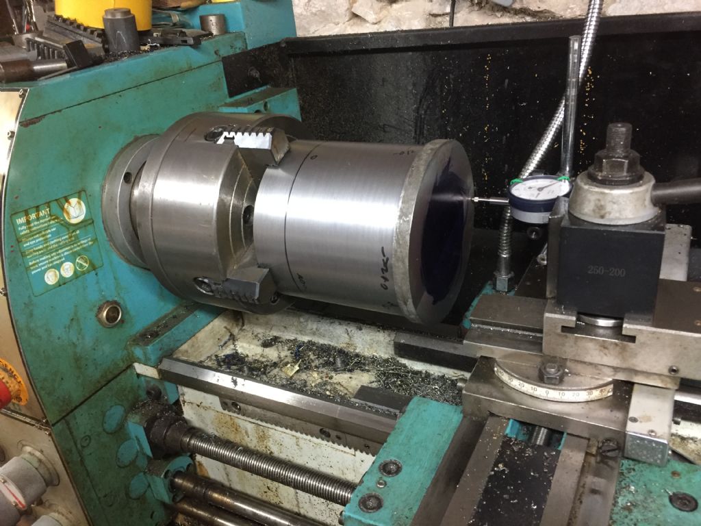

                                  Robin Graham
                                    @robingraham42208
                                    Thanks for replies. It's reassuring to know that my plate is OK, and I take the point that if I mounted it again it would measure up differently. I'm envious of Jason's precision though!
                                    As things turned out the job was turned and faced one end in the 3-jaw, then reversed and set in the 4-jaw to finish:
                                    Slightly scary swinging a 24kg 160mm diameter billet at 700rpm (there was a time-served RR engineer present, he said it was OK!). Anyhow, it worked and no people or machines died.
                                    It's been an instructive project on several fronts. I'm learning I hope!
                                    Robin.
                                    PS the 700 rpm stuff was with tailstock support before anyone has a heart attack.
                                    R.

                                    Hopper
                                      @hopper
                                      Well done. Good to see a result and thanks for posting a result. So many dont bother.
                                      One point with the reading in Jason's video is that it is usually recommended not to run a dial indicator on a shaft or job rotating under power at speed like that. Apart from wearing flat spots on the plunger end, the side loading on the plunger combined with the speed of change in reading can result in the plunger binding and massively under-reading the run out. Recommended practice in most camps is to rotate the spindle slowly by hand to get the most accurate reading. I'm sure Jason would have done that too but the video does not mention it so could be a bit misleading.
