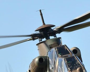

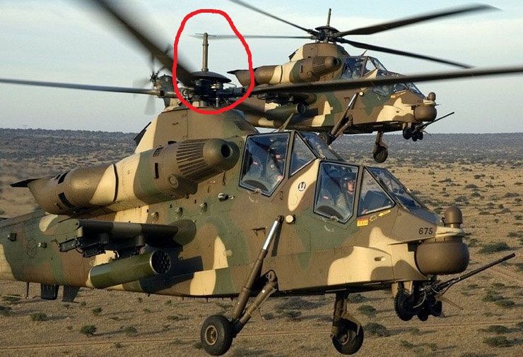

                  A bit off-beat maybe… I designed an Omni-directional Airspeed sensor (OAS) that sits atop the standpipe above the main rotor on the SAAF Rooivalk 'copter. A 350mm horizontal tube 10mm OD, with pitot holes in the tips at opposing leading edge, feeding two pressure sensors. The tube spins ( like the "copter rotor..) and if standing still with no wind, the differential pressure measurement is nil. Any wind ( from wind or motion) creates differential pressure in a sinusoid voltage, which is proportional to airspeed. A optical encoder disc fixed to the vertical spinning shaft gives position of the spinning tube relative the the sinusoid, and from this is derived wind direction. The device was calibrated in the Wind Tunnel at the CSIR…
                  I still have the prototype which I use on the ground when we go fly our UAV in the desert – to derive landing approach for wind direction and speed…
                  EDIT – we had a 20meter rail with a winch towed carriage in the lab – the OAS was mounted to the carriage and the winch would wind the OAS along the track – from 0m/s to 10m/s within 15meters. Carriage speed and OAS data was logged and a calibration curve for the sensor derived. We were generally within 3% of the wind tunnel cal results..Air cons were turned off during the runs…
