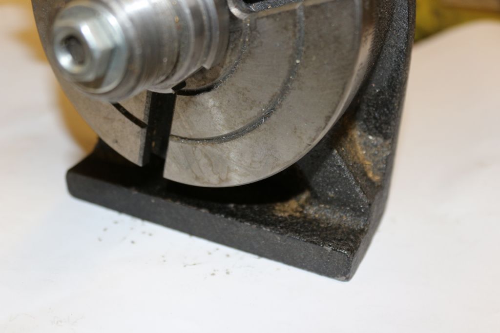

      If you don't want to make a sub base for the table, (probably mean drilling and tapping the base and using countersunk screws ) with holes to match the T slots on the table of the Mill.
      Is there enough "meat" opposite the flat base to drill a hole, say 8 or 10 mm dia?
      If so, you could clamp the table in the horizontal position, using a finger clamp in the slot, and a"special" finger clamp with a spigot to fit into the drilling. Shorten an ordinary finger clamp, and then drill (and tap ) the shortened end for a dowel or stud..
      That would give two clamps, diametrically opposed.
      Presumably, the flange is drilled to allow it to be bolted down when in the vertical position?

          Howard, no the flange isn't drilled or slotted. I think this view might help?
          I think I can see where you are coming from with the table is used in the position in this picture (finger clamps).
          One advantage of this table is its low profile which is handy for the small mill that I have but like most products that I have ever bought these days, a bit of extra effort and tinkering is required to make them useable.

            Phil, that flange looks just ripe for a couple of holes, or slots, to match the pitch of the Tee slots on the Mill table.
            I had to extend the slots on my HV6 and use smaller studs that I thought (M8 instead of M10 ) for clamping. But a M8 stud and nut are quite capable of exerting enough force to crack a table, so hand pressure on an ordinary spanner will provide sufficient clamping.

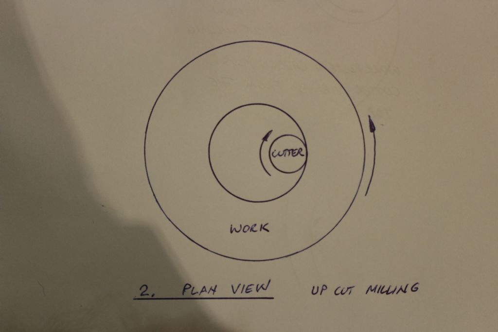

                  If you think about it for a few minutes – with the rotary table spindle pointing upwards (parallel with the mill spindle), up cut milling the edge of a work piece like the ends of a connecting rod will always tend to unscrew a Myford style chuck.
                  I have a Myford, MT2 adaptor and It isn't too difficult to clamp it into the rotary table spindle – similar to your description. It is the cutter movement which tends to unscrew the chuck from the adaptor that I am concerned about.

                          I might have misunderstood your description so I did a couple of sketches.
                          This is the arrangement I have. Figure 1 is quite a common cutting direction with a part like a connecting rod end. No matter how you drill holes or arrange the part, this will always tend to unscrew the chuck if you use up cut milling.
                          You could avoid the chuck and bolt the part directly to the table of course or held on a spigot in the spindle of the rotary table.
                          Figure 2 avoids the unscrewing action when milling say the inside of a flywheel – but that isn't very common and again you could of course bolt the part directly to the table anyway.

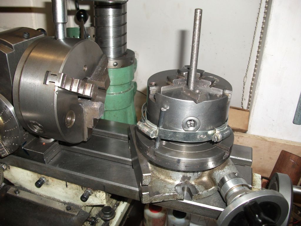

                                My Myford chuck is mounted in a similar way on a screwed
                                fitting on the rotary table ,to prevent it unscrewing during milling
                                operations you only need a long enough tee nut a piece of
                                studding and a hose clip or three fixed together as in the photo.
                                The tee nut will slide in and out to suit the diameter of the chuck,
                                the assembly is biased towards the undo direction as the
                                hose clip is tightened.You can mill in any direction you wish to.

                                  Now that's what I call helpful. I really love simple solutions like that. My table is quite small so I might need an offset T net and or pin to clear the chucks that I have.
                                  I was actually considering a drilled hole in the chuck backplate to engage with a similar pin but your idea is better.

                                    A wonderful example of effective simplicity.
                                    Phil
                                    If your chuck is too large to let the stabilising pin drop into the Tee slot maybe the extra work involved in stealing the concept of a more engineered version that I encountered on a piece of lab kit will be worth while.
                                    That device had a split clamp type carrier that did the equivalent of gripping your chuck backplate having a drilled lug and locking screw more or less opposite the split to hold the location pin. The pin itself was L shaped so it could pass underneath and of D section where the locking screw impinged. As the screw locked up on the flat the pin couldn't be turned by pressure on the bent end so all was stable.
