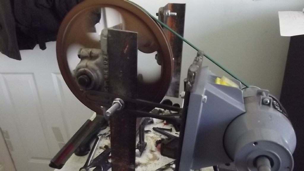

      Does anyone know how those cheap chinese bench grinders are made to sell so cheaply? I am not sure where I could get a 150w motor from for less than £30 but you can get a bench grinder in Screwfix for £18.
      In this case it was free but here is the "Cougar" benchgrinder I made into a lathe countershaft.
