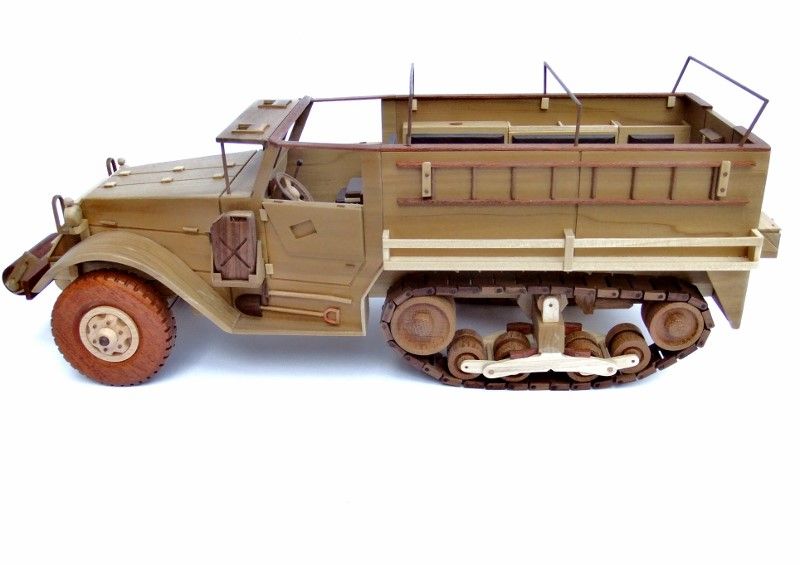

              I have never had problems from the natural oils from my hands when finishing wooden models. If however you are talking oil and grease that you have picked up from handling metal engineered models and the like the hand cleaning is the answer before working with wood.
              Oxalic acid will clean it off but if left on may dis-colour the wood as in that it can act like a bleach.
              I don't paint my wooden models but do apply a lacquer for protection after applying a sealer first.as in this model

                    Very nice. What scale is it? and how did you make the tracks?

                        I did not make it to a scale but it is 17" long to give an idea of size.
                        The tracks are mad of three components the pad a guide cleat and the pin. There are 66 pieces of each component all machined. The pads where all machined to width and thickness in long lengths then cut to size. I made a jig to route either the tongue or groove. Also a jig to drill the holes for the track pins.
                        It took three days of cutting and assembling both tracks

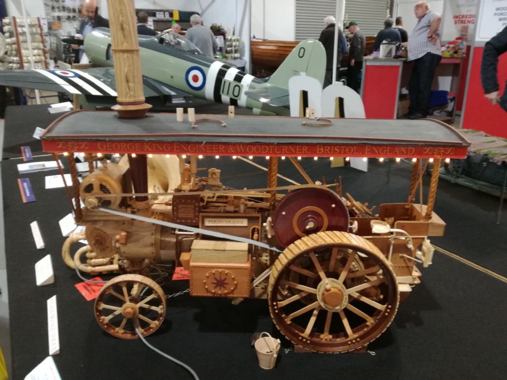

                                  Hi Derek, well this wooden traction engine was in the Midlands Model Engineers Exhibition awhile ago along with a few other bits of wooden models and there is normally many wooden boats, ships, aeroplanes and even models of farm related things all made with wood at most exhibitions.
                                  Needles to say the guy who built the engine, didn't fancy lighting up the boiler.

                                    Now that is amazing Nick way beyond my humble model
