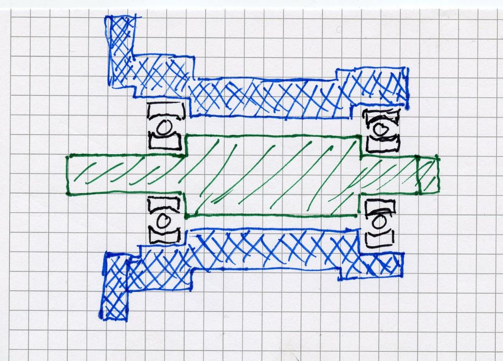

                          Hi pgrbff, I can't guarantee it, but I image the cross section sketch below is what your bearing assemble arrangement looks like.
                          It is quite likely that the position of the shaft is fixed by the plate at the flanged end and the plate will nip the bearing in the correct place and there may be a small amount of end float on the outer race of the other bearing. it is likely that the bearings will be a press fit onto the shaft.
                          Regards Nick.
                          P.S. The sketch is probably nowhere near to scale, but it should give you the idea.

                            Many thanks for taking the time to do the sketch. That is the conclusion I have come to, but I have little experience in these things. I have a friend with a press, he owns a motor workshop, and I'll have to try and get over to him. The trouble is lockdown prevents me to go to another province, Liguria, so I'll have to wait.

                                    Finally apart. Exactly as Nick suggested. Had to find someone with a press in the end.
                                    Thank you all for you help.
