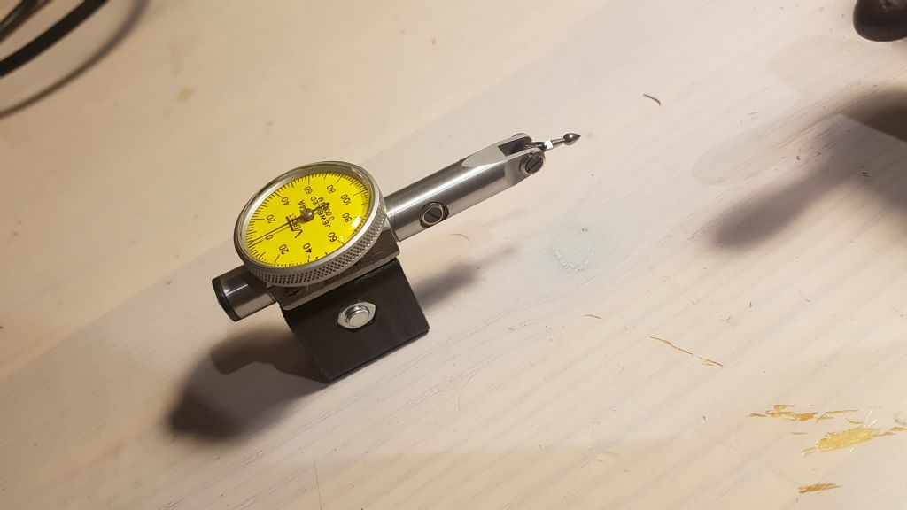

        As my first DTI, I happened to purchase a secondhand Verdict T4A, and it has me a tad confused on how/whether to adjust the "zero" angle of the lever. I thought that'd normally be done by simply pushing on the tip once it bottoms out, but that doesn't seem to do anything, and I can't even begin to loosen the screws on the side. I naturally want to be quite careful with it, as it is a 0.002 mm indicator, so I do not want to try to brute force it.
        Any advice would be appreciated.

          Im not familiar with the Verdict but on all of the ones that I have the lever has a friction grip and simply twisted to the angle required.

            That's exactly what I was thinking, but it doesn't seem to work that way — maybe someone more familiar with the Verdict can tell me whether this model is different, or perhaps just stuck.
            #450323
              Mine is not that model … but I thought they all worked the same way, in that there are detents, loaded by a spring.
              Is there a leaf spring visible of the ‘dark side’ of your photo ?

                As far as I can tell, it's just a linkage leading to the internal mechanism, there is no spring that I can see. The catalogue and thread look interesting, but my model doesn't seem to be listed — shame, since it seems to function somewhat differently.

                  Have you tried turning the screw on the side clockwise?

                      On mine there's a leaf-spring with a pip that engages in a series of detents. You set it into one of them by 'brute force', though it's not really very brutal…

                        Rod, I've tried, but I am not capable of moving any of the screws, all of them seem to be very solidly locked down. I am not sure if this is intentional, or just a part of how old the indicator is.

                          Don't touch the screws, they are carefully-set pivots. Just push the lever round. I have one that is tight but they all work the same, by simply pushing them round.

                                              The stylus on the 0.0001" T4A I have needs a firm push to adjust the angle. Simple friction grip. Which I believe is correct.

                                                Clive, thank you — I got the courage to give it a proper push, and what do you know, everyone here was correct, it just was really really stiff. I'm not sure I would have normally pushed it this much, I would have been afraid of breaking something. Thank you to everyone for their advice and help.

                                                  Some of the lever indicators have a centre zero, and others have a lever to set the direction of travel. As for the angle of the pointer, all types just require turning the pointer to the angle required. No harm will be done to the instrument, they are designed to do this. Sideways bending should be avoided at all costs, it is the commonest cause of damage. Later models of Mitutoyo have a groove in the pointer which acts as a safety to break before the mechanism is damaged.

                                                    After a bit of adjusting back and forth, the mechanism has become extremely sticky to the point of being unusable, and there is now tremendous slop on the lever. I hope I haven't just scrapped this DTI, because this does not look good at all.

                                                      Sounds like it needs some 'expert' attention, the lever spindle may have come out of the miniature bearings? which could cost, sorry.
