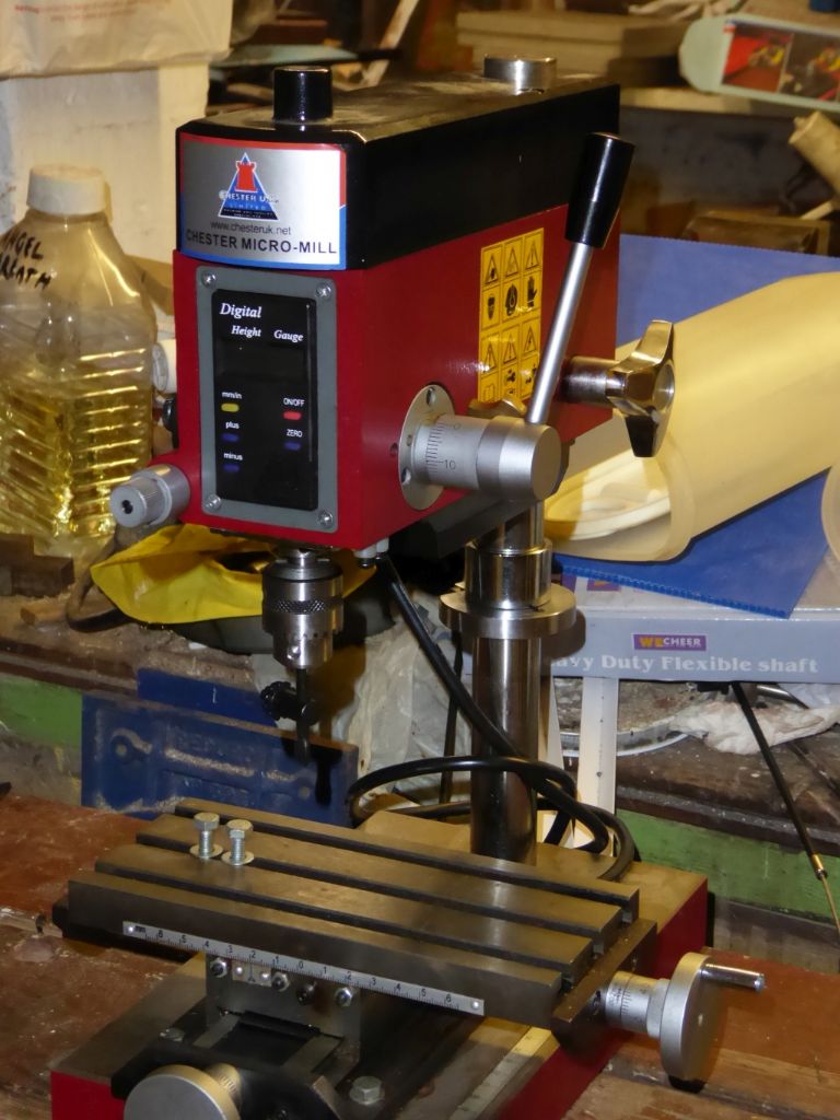

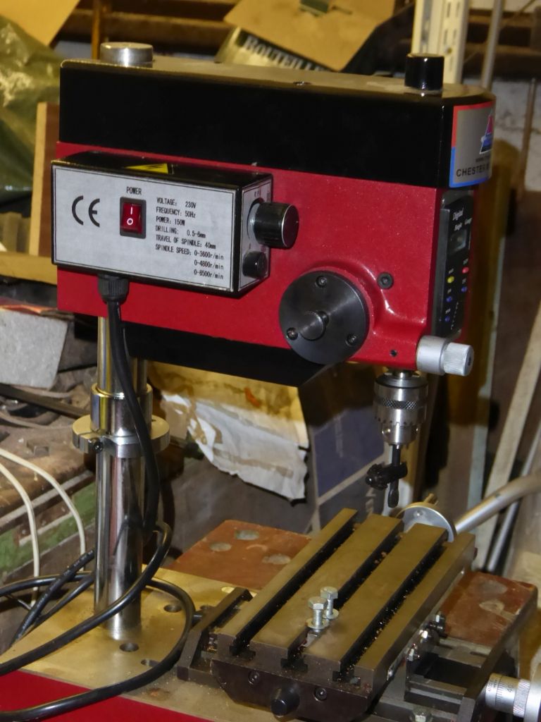

      I've got a Chester Micro-Mill in "as-new" condition. Everything works OK except that there is too much vertical play in the quill. There's no noticeable play between the spindle and the quill, but after setting the quill to a particular position, either by the lever or the fine control, it can be pushed upwards by about 1mm. Which makes drilling to a particular depth with a 0.6mm drill rather hazardous.
      Does anybody have an exploded view of the mill, or know how to remove the play?

        John Stevenson 1
          @johnstevenson1
          The lever a few fine feed control both work through the rack and pinion so it may be here where your play is.
          This usually doesn’t matter as you drop your cutter or drill on the work, then set the depth of cut. Any play above this doesn’t matter unless I’m not reading your post correctly

              When the depth of cut has been set it is possible to lift the quill by about 1mm.
              I noticed the problem when I needed to drill a 0.6mm blind hole, 1.8mm deep, in a piece of precious metal 2.3mm thick. With such a small drill there is a real possibility that the weight of the quill will cause the drill to descend too far.

                            The DRO tells me the position of the quill but, because of the play I cannot control that position. I can set the depth stop but that only controls where the rack pinion stops, not where the quill stops. With the pinion locked it is possible to move the quill up by about 1mm. If I set the DRO to zero with the drill touching the workpiece and the backlash taken up, then I have to be very careful when the DRO gets to 1.8mm 'cos I can't rely on the drill not getting sucked in further because of the backlash.

                                  #302827
                                  Ketan Swali
                                    @ketanswali79440
                                    Hi Gary,
                                    You mention 'precious metal'. Are you a jeweller, watch or clock maker?..
                                    Are you new to working with 'cheap' machines?
                                    If combination of the above, then please don't waste your time trying to figure anything out. I say this with the greatest of respect. From experience of selling to professionals as well has amateurs in the above field, I can tell you that professionals buy and modify this machine somehow to meet their precision requirements (don't ask me how as I don't know), and persons who are new in this field (expecting high precision drilling) usually end up disappointed.
                                    The X0 does have a variable amount of end float due to the rack and pinion arrangement on the quill. 1mm movement seems to be a little on the high side, so are you sure this is the case?. It works as it is supposed to, as it was designed, for the purpose of 'drilling' metal. Almost all drilling machines have such end float. It is not designed as a high end precision drill/mill.
                                    Certain people such as Frank Crispin – well known in the hydrological arena have stripped the machine and added bits to it to remove end float, to meet his precision requirement. Otherwise, his words: ' he would have to spend around three to four times as much' to buy a high precision micro drill for his purpose'.
                                    For milling, one would lock the quill by tightening the large socket head screw (which originally used to be the locking handle part 96 on the exploded drawing.).. this would remove the end float for the purpose of milling.

                                      It does seem as if the play you are seeing is in the rack and pinion so one workaround would be to arrange a spring to pull (or push) the quill upwards. The spring needs to be strong enough for the quill not to be dragged down say, if a drill breaks through when drilling brass. The spring will overcome the backlash problem but its not a perfect solution.
                                      By adding a second spring you will lose some feed sensitivity so you will have to experiment. The diameter of hole you mentioned is best done with a rigid machine designed for the purpose.

                                        There is already a spring fitted. It’s part number 15 and is adjustable by removing the three screws behind where the graduated ring goes. Take care when you release the last screw as it will want to unwind. Just wind a bit more tension on it and replace the screws
                                        I’m a bit non plussed why Gary can’t set this up. A while ago I got a contract to supply some capillary housings in large quantities in brass
                                        The OD is CNC turned and then they go onto 2 of these Sieg X0’s for drilling. These were bought just for this contract and remain set up. The first machine drills a 1.8 mm hole 9.5mm deep the second machine then drills a 0.4mm hole all the way thru which is also 9.5mm deep
                                        The reason for the stepped hole is so two tiny copper pipes can be soldered in. I have done in the low thousands in snatchy brass and never lost a drill or a part yet

                                          Notwithstanding your good results with the parts you made, the spring (15) acts on the pinion shaft. When the pinion is rotated the leading face of the teeth push the rack downwards. If the quill is a close fit in the casting there is enough friction to keep the same gear faces in contact as the quill travels down and they remain in contact once the drill is in contact with the work. If the quill is a loose fit though, gravity will keep the back of the teeth in contact and they will stay contact until the drill touches, there is then some lost motion as the pinion catches up with the rack.
                                          I think the X1 type mill has the quill return spring acting directly on the quill so does not suffer this particular backlash problem.

                                              Because the problem is due to slack between the quill rack and the pinion, one solution could be to determine the number of teeth and pitch (presumably metric module) of the pinion, then order an approptiate anti-backlash gear from the likes of HPC gears. Note that this is not a cheap option.
                                              It may also be possible to fit a compression spring between the top of the quill and the bearing seat at the top of the head to pre-load the rack/pinion slightly. Hopefully there would be enough movement available in the quill return spring to be able to increase its tension to counteract the additional spring.

                                                  No, there is no quill lock, only a depth stop that works on the pinion lever.
                                                  Subjectively, without dismantling the machine, it feels as if the quill is biased to remove all reverse backlash. In other words, it's as if the quill is heavy and rides on the rear of the pinion teeth – if the lever or the fine-feed is used to position the quill anywhere, it's quite easy the push it up by about 1mm.
                                                  In the final analysis I think it would be better, short of removing all backlash, to have forward backlash, as could be achieved with a spring to keep the quill pushed upwards, but then there could be problems when drilling through holes.
