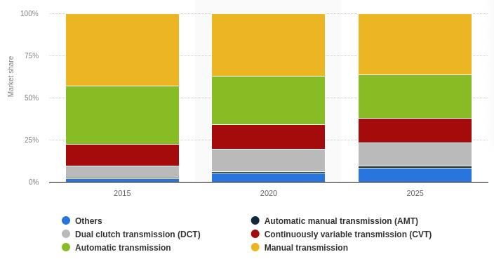

                                  #647935
                                    Posted by john halfpenny on 09/06/2023 11:10:31:
                                    … but of course manuals are no longer required by most users.
                                    Though manuals are in decline, they're still the most popular single type of transmission as this graph from Statista shows:
                                    Quite interesting to see what manual gearboxes are losing out to – it's not plain automatics, sales of which are also dropping. Winners: AMT, rare but growing slowly; with CVT and DCT both big players.
                                    There's a mystery! The graph shows the fastest growing transmission type is 'others', predicted to have 9% of market share by 2025. I guess these could be the incoming electric transmission systems, does anyone know? Or are there other types, perhaps driving hydraulic motors on each wheel?
