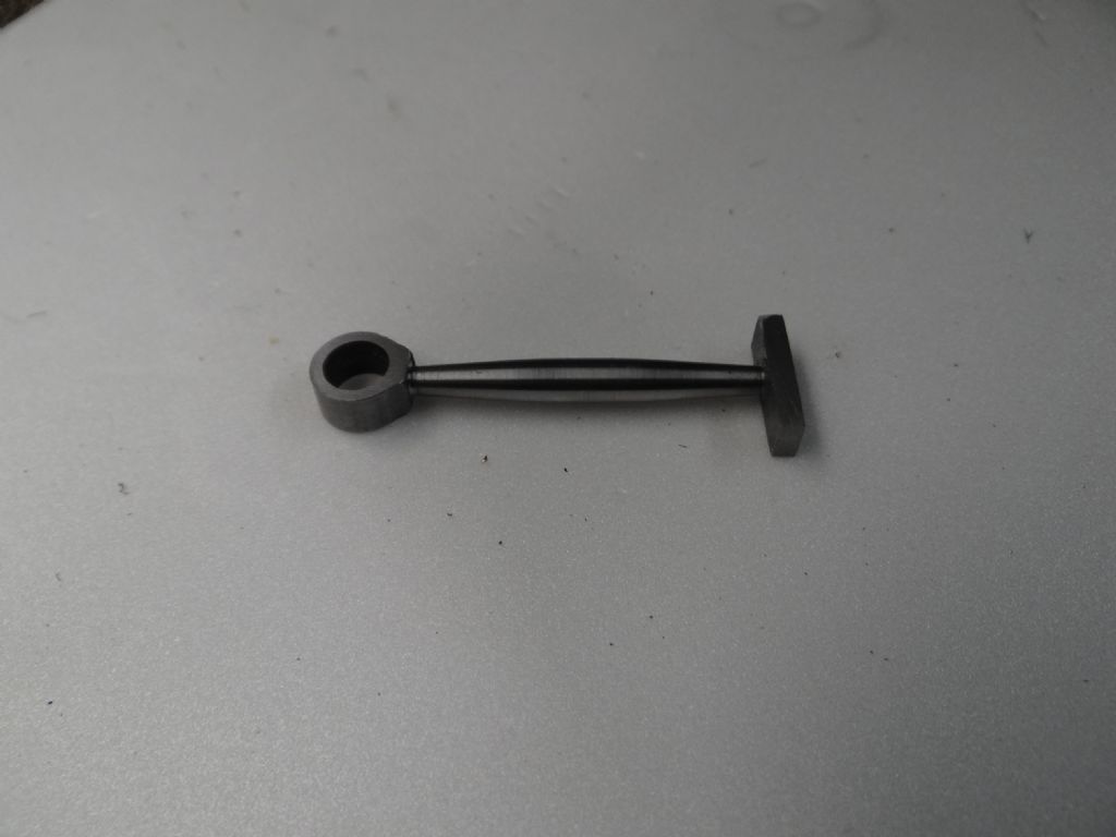

                                          Reporting back, success with cutting to calculated curve coordinates followed by blending. The radius is closer to 295 than 300mm but I blame operator error for that.
                                          I'd be a smug bar-steward except I spoiled the part during roughing out.
                                          Now, do I put the mangled con-rod in the engine flawed side down in the hope that no-one notices, or do I start again and do it properly? Ho-hum…
                                          Edited By SillyOldDuffer on 09/10/2017 18:01:45

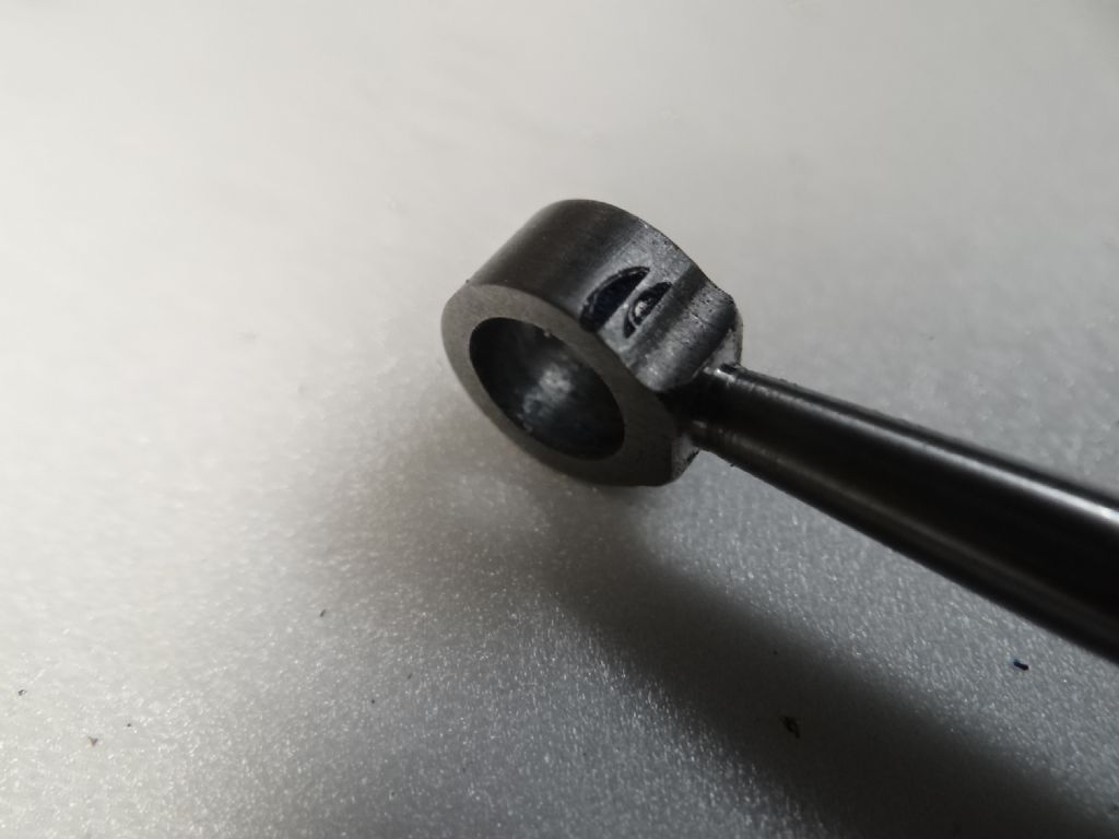

                                          Howard Lewis
                                            @howardlewis46836
                                            Maybe I'm over cautious, but in my book, the pock marks in the pin end, would make it scrap for a running engine, because the sharp corners would be stress raisers liable to result in a fatigue fracture.
                                            Blending away the metal around the notches will weaken the eye appreciably, so to my mind, not on, for a runner.
                                            To horrify everyone, if it is to be purely a show piece, you could hide the errors underneath, and agonise all the way into the future!
                                            As the late Peter Robinson, said, once, in jest, " If you can't make it right, make it bright". But he never seemed to make it wrong!

                                                Posted by SillyOldDuffer on 09/10/2017 18:01:14:
                                                Looking good, but is it a trick of the light that it looks trapezoidal rather than circular? May be little more work with files about a third, and two thirds, along?
                                                If it were me I'd swallow hard, bin it, and make another one. On the plus side it won't take nearly as long. And as I know to my cost some members of this forum seem to have an unerring eye for mistakes when one shows parts. sad

                                                  Posted by Howard Lewis on 09/10/2017 18:56:59:
                                                  Howard
                                                  The stress raiser caused by that little crescent shaped gouge will be as nothing compared to the stress raiser where the rod bit meets the eye with no or very little radius. The section through the eye has a lot more area than the end of the rod for starters. If it were mine I'd just fill it with cellulose putty or similar and give it a coat of paint.

                                                    Posted by Andrew Johnston on 09/10/2017 19:49:49:
                                                    Looking good, but is it a trick of the light that it looks trapezoidal rather than circular? …
                                                    Andrew
                                                    After all that fuss making it d**n*d thing it looks trapezoidal in the picture. Doh!
                                                    Fortunately it's OK in real life; I think the effect is probably due to me tilting the camera.
                                                    I think you and Howard are right though – it has to be done again. I can't deny I need more practice. Much more!

                                                      Posted by SillyOldDuffer on 09/10/2017 20:43:23:
                                                      That's a relief; possibly shadows?
                                                      Practice makes perfect, or so they say; didn't work for me. Better, but definitely not perfect. smile
