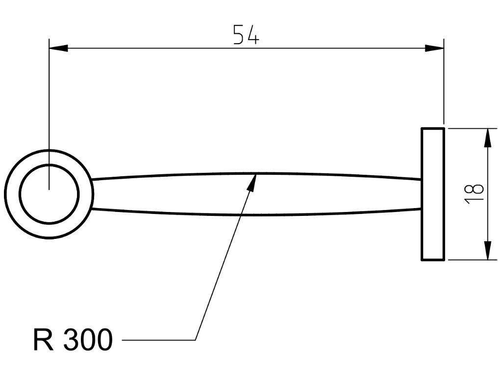

        This item is the con-rod for a model mill steam engine. I'm trying to make it properly as per plan.
        The rod part of the con-rod is of circular section and the whole is curved on a 300mm radius. The rod is ⌀4mm at the ends and it bellies out to ⌀6mm in the middle. In a full size engine this is done to minimise the weight of the rod whilst keeping it stiff enough not to kink under compression.
        My problem is that I don't how to turn that R300 radius along the rod. I have a manual lathe. The curve implies that the tool point has to smoothly move in – out – in as well as from right to left. I prefer not to approximate the shape with tapers because that's not what the specification calls for.
        Can anyone help please?

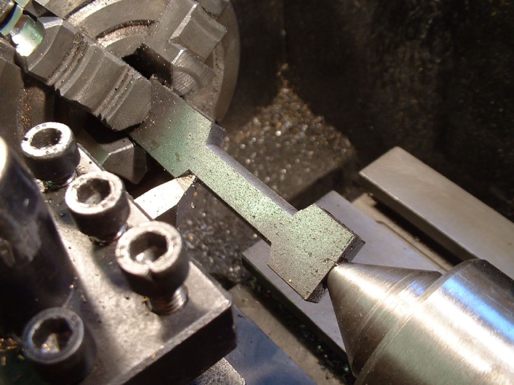

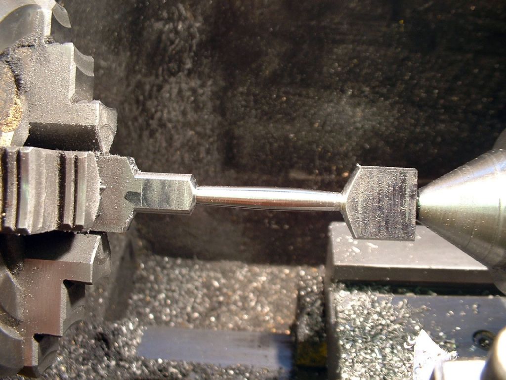

                    Have a look at my post part way down this page on Fish Belly rods, will also look better than that one in your drawing with the constant radius
                    If you do want to keep to the 300 rad then work out a set of co-ordinates at say 1mm steps and machine to that then blend with a file.

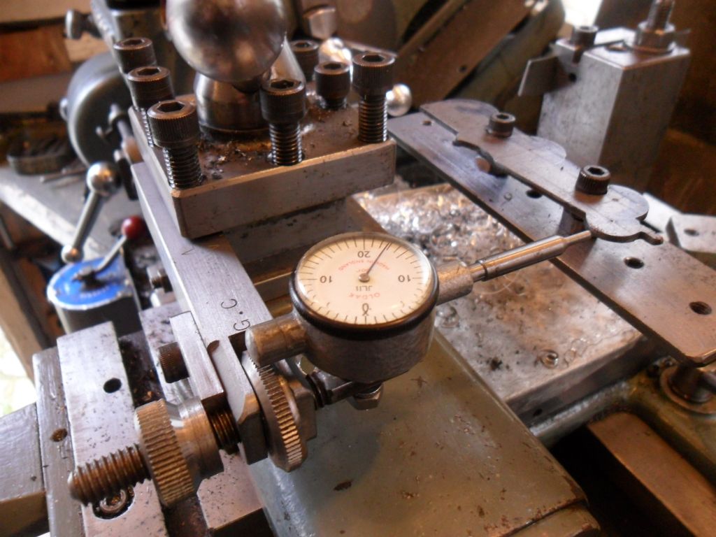

                      Nobby
                        @nobby
                        I would say make a template like Mike says set up similar to my effort  The template fits in to tailstock Nobby
                        Edited By Nobby on 06/10/2017 23:22:51

                            Nobby's idea is ideal for this job. I did a similar set up for a model loco smokebox door. Use slow power feed (sliding), and keep adjusting the cross slide to follow the template. you have to keep watching the dti, and try to keep the needle in the same place. Best to work from the middle of the template, as you have to wind the cross slide in to keep up. If you get behind with the cross slide you just stop cutting, and don't spoil the job.
                            #320384

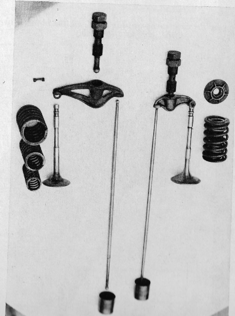

                              Many years ago I had to make some fish bellied pushrods for a 1930 sports car. They were very slender and tapered in a gentle curve at both ends to the ball end to reduce the reciprocating mass. The originals had been made by a knitting needle manufacturer! The method I used was to mount them near the centre in a collet and then support the end in a female centre which was offset to give the correct taper by bending the rod. That resulted in a nice curve in one pass. The ball ends were than case hardened and polished.
                              The pushrods were about 1 ft long and 5 mm maximum diameter so flexed easily. It might not work on Dave's shorter rods but the method is worth remembering for longer rods.

                                Your method sounds similar to the Tubal Cain method I mentioned earlier (my description of it was not very good).
                                The fish-bellied push rods remind me of Bugatti's banana-shaped tappets.

                                    This one is done as a bender, I tend to use that more for rods that taper in one direction rather than two. Small live ctr in a boring head to get the offset.
                                    The other thing that is not good in the OP's original drawing is the abrupt junction where rod meets flange and small end, just asking for a fracture, best to have a small internal radius where they meet.
                                    Edited By JasonB on 07/10/2017 13:16:13

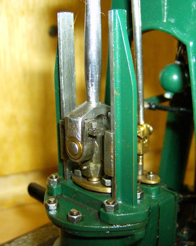

                                        As Jason has pointed out, if you copy the 300 radius you need to copy the sharp corners to be true to the design
                                        I would ask the original designer how HE did it!
                                        Anything other than blending some taper cuts seems OTT.
                                        I'm sure that's how I did this one…

                                          Posted by ega on 07/10/2017 11:41:12:
                                          The Talbot used an interesting rocker design as well:
                                          #320423
                                          ega
                                            @ega
                                            "The Talbot used an interesting rocker design as well:"
                                            Again, the aim seems to have been to reduce the reciprocating weight; I notice that the valves were waisted, too.
                                            Was the Talbot a Georges Roesch design?
