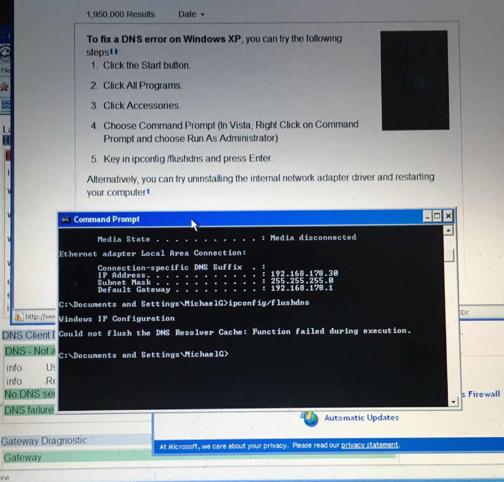

        Please don’t expend any great effort on this, but if someone has an easy answer, I would appreciate it:

              In fact, however, the present situation is that although the XP machine [an old Sony Vaio] is happily connected to my Router
              • it cannot see any other device on my wi-fi network, and it cannot access the internet
              • Opening Internet Explorer 8 allows me to search [with results coming from Bing]… but then clicking any URL fails to connect.
              My naive interpretation is that Router’s security settings are too high for the Vaio to be accepted
              < Unclean ! >
              But somehow Bing seems quite content … that’s what bewilders me

                            Posted by Ady1 on 26/08/2023 09:17:42:
                            Must be to do with the MS set up system using trusted proprietary software so no permissions required
                            Unlikely – the router and network don't trust Microsoft, or anyone else.
                            More likely bing has cached some pages locally, and isn't using the network. It fails when a page can't be found locally, and the computer has to get it from the web.
                            As Michael says 'it cannot see any other device on my wi-fi network, and it cannot access the internet' I suspect the XP network configuration is wrong. Assuming a physical cable to the router, in network settings:
                            First thing to check is the XP sub-net mask, which controls how IP addresses are interpreted. Home networks are usually 255.255.255.0 All devices on the sub-network have to share the same mask; if not their IP addresses are incompatible.
                            Second thing is that XP has a valid IP address. Could be static, where an administrator allocated and set the address in both computer and router. More likely, XP should be set to ask the router for a dynamic address at boot time (DHCP).
                            XP can't connect to the network without a valid IP address.
                            After that we're into driver and hardware problems. Wifi works the same way, with an additional layer of complexity – it's encrypted, requiring passwords, and protocol and other settings. Fault finding, always get it working with a cable first.

                                Thanks again, Dave … I got there in the end !
                                [ or at least as far as I want to get ]
                                After going round in circles, I eventually arrived here:
                                There was enough displayed in the Bing result to point me in the right direction
                                I uninstalled the Intel network adapter, and let Windows reinstall it.
                                Went back onto wi-fi and can now browse files stored on the Vaio, using the FileBrowser app on my IPad
                                … after a hair-pulling few hours, that will do for today
                                … I will probably need to tidy-up various file-sharing settings on all the devices; but at least the Vaio is now a member of the gang !
