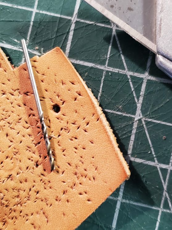

                                            clivel
                                              @clivel
                                              Posted by Michael Gilligan on 26/02/2022 00:24:02:
                                              Whilst I respect your experience and expertise, Clive … I feel obliged to mention that the proposed radius is 0.75mm, which might make it tricky to use your proposed ‘washer or rod’ as a template.
                                              Hence the plates suggested by Robert Butler, and endorsed by me.
                                              MichaelG
                                              Well, I guess that the proof of the pudding and all that ….
                                              I used a 1,5mm drill bit as a template. Unfortunately, the only scrap of thin leather that was easily accessible without going into the freezing cold garage had been used as a punch backing, hence the numerous diamond-shaped slits.
                                              But to be honest, I don't really see the point of a 0,75mm corner radius, it is barely noticeable without a magnifying glass or close-up photo,
                                              Clive
                                              Edited By clivel on 26/02/2022 19:00:01

                                                  #587377
                                                    Posted by clivel on 26/02/2022 18:58:30:
                                                    MichaelG
                                                    Well, I guess that the proof of the pudding …
                                                    An interesting demonstration, thanks Clive … but I confess to being a little confused regarding its relevance: The OP’s requirement is, it appears, to produce a ‘male’ quadrant on the corner of a sheet of soft rubber.
                                                    Edit: __ Apologies, Clive … I have only just noticed your corner-rounding blush
                                                    … I was looking at the round-ish hole in your leather blush
                                                    Edited By Michael Gilligan on 26/02/2022 21:48:11
