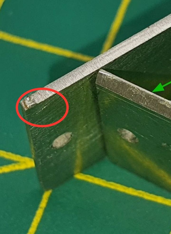

                                Howard, I have mentioned bench shears in a previous thread about sheet metal cutting, I even demonstrated it, the OP drew up a cad model showing potential microscopic edge deformation showing this method wouldn't be suitable.
                                Since then the OP had the parts laser cut, the laser cut parts he had made looked like they had a rougher edge than the bench shear.
                                The photo below is the demo I did to show the part would remain flat, but apparently microscopic edge deformation means this is no good.
                                Edit to add the OPs original method mentioned the edge would be fettled for final finish, so why this microscopic deformation was a problem I don't understand.

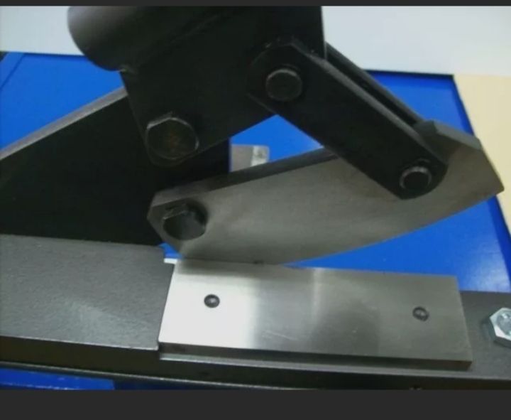

                                        I didn't forget about the requirement of needing to put it on a shelf when not in use, mine weighs about 12kg and it's no problem putting it on a shelf when not in use , you can buy this small bench shear from a Polish seller on eBay for around £70, it weighs 6kg, I don't think anyone would struggle to put that on a shelf.
                                        The lower blade is also positioned horizontally, so it acts as a small table which is quite useful.

                                          The circled area that was laser cut appeared to look rougher than what I got using a shear, I'm just saying a bench could create 4 straight edges in maybe 30 seconds or so, effortlessly.
                                          Edited By Pete. on 06/11/2021 01:43:27
