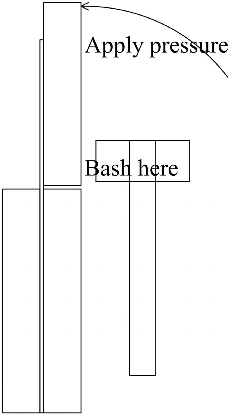

                                    I sometimes need to do this sort of thing, without cosmetic damage. What works well is to hold the sheet in the vice between pieces of wood or better, faced kitchen type chipboard. This usually needs to be cut specially to fit. Align the chipboard edges and the fold line. The chipboard is potentially sacrificial.
                                    Now press a third bit of chipboard so as to produce the bend. However, this will make a curve not a fold, so using a mallet, hammer the chipboard as near the fold line as possible. You can form a good but not fully sharp fold this way, without marking the metal.
                                    Sorry drawing is a bit big!

                                              As Malcolm describes – I have also used this method several times (I have some offcuts of beech worktop that work well for this).
                                              For 1mm stainless, you will need some substantial clamping boards, and a couple of G clamps over the ends to stop them spreading where not held in the vice.
                                              Take it steady, a little at a time, working along the full width of the sheet.
                                              If you use metal clamping bars you will get a sharper bend, but also (likely) scuff marks near the bend.

                                                  Andy-G is quite right, 1mm stainless sheet is about the limit of the technique I described, and it will need more than chipboard or MDF. The two pieces of steel sound OK, and a layer of masking tape usually protects against marking. Remember stiffness is a cube law, 0.5mm should be 8 times easier to bend than 1mm! As he says, a hard hardwood piece (eg beech, oak) to make the corner of the bend is indicated, Mahoganoid will be no better than softwood.
                                                  If the bend angle is made too great, place the corner edge on a flat (expendable) piece of wood, put a bar 10mm or 15mm diameter inside the corner, and hammer it via a another wood board to “draw" the angle (this will spoil the bar for precision purposes).
