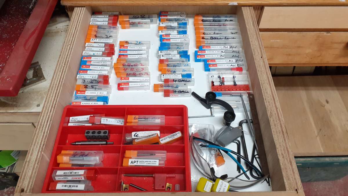

                    On the cutter size front, this is the draw next to my CNC, just one 8mm and one 10mm in there the rest are 6mm or smaller. Do have 25mm and 50mm insert cutters in another draw or larger in the other workshop.

                          It certainly helps to have used a manual machine first as it should have given you a basic understanding but having a CNC certainly needs a bit more thought and you will think a lot more about depths of cut and feed rates as you start to use one. You are also likely to have much higher spindle speeds available and the ability to move the table far faster than you could wind a handwheel so best to use them rather than apply your manual thinking. This also applies to the type of cut and what parts of the cutter to use.
                          This is another good reason for not having a vast range of cutter sizes as you will get to know what works on your particular machine for a given material and type of cut. I tend to know now what works and have those parameters set in the tool library so I can just select the tool for the job and it has my basic known settings there and ready to go or be slightly tweaked depending on the job. The machine could certainly take more aggressive cuts but I’m happy to use the ones I do as a good all round balance of machining time against tool wear, swarf clearance and not putting too much load on the machine.

                            one other factor that comes into play with size of cutter particularly if you are going to make use of carbide is cost.
                            If your machine is only capable of say taking an adaptive cut of 6mm high by 0.6mm sideways then unless there is a specific need why use a larger cutter as you are going to wear the end 6mm of flute of a 12mm dia just as fast as you wear those of a 6mm cutter but it is a lot cheaper to replace a 6mm one than it is a 12mm one.
                            Same applies for those early tool crashes, you won’t cry for as long after breaking a 6mm dia as you would a 12mm. Also the 6mm is more likely to break which could save further damage to the machine if something else has to fail when a solid cutter is driven into an even more solid block of metal.
