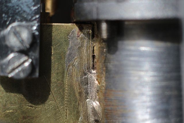

        Hi all,
        I've nearly finished Mogen Kilde's Miniature Side Lever Steam Engine (ME 11 Jan 2011). It is my first model engine and I've got a problem. The work also included my first attempt at silver soldering because I used Silverflow 55 to attach the brass steam chest to the mild steel cylinder.
        The joint is OK except for a 5mm gap at top right where the solder failed to flow into that part of the joint. Trying to run the engine on air reveals that the piston operates only on the downtroke and that my dodgy joint leaks on what should be the upstroke.
        What's the best way of fixing a mildly botched silver solder joint please? I can't find anything on fixing brazing mistakes in my books. Should I simply reheat the cylinder and apply more silver solder to the gap or am I in big trouble? (I've done electronics where remelting old solder isn't a good idea – it's often better to remake with fresh solder.)

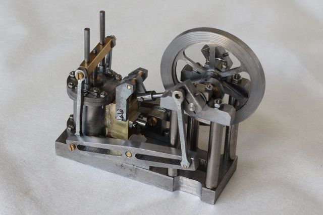

                                        Very many thanks to everyone! Excellent responses.
                                        As a picture is worth a 1000 words here is a snap of the best side of the engine. It is 100mm long and needs more tidying up apart from the duff joint.
                                        Next a close-up of the bad joint which is on the other side of the cylinder. The scale is given away by the out-of-focus M2 screwheads.
                                        As it came from the hearth the fillet ended in an unsightly blob that I ground off with a Dremel. That's what skidded over the brass leaving the odd circular marks.
                                        pgk spotted that my original post is ambiguous about the size of the gap; it's about 5mm long not 5mm wide. The overall joint seems to be mechanically sound but I'm suspicious about what lies beneath especially under the cylinder flange.
                                        As it's unlikely that the engine will ever taste live steam I'm going to try soft soldering as per Neil and IDP. Michael's Locktite suggestion is very tempting but I don't have any 290 to hand and can't go shopping until Tuesday. Wensleydale will on my list.

                                          #184179
                                            Hoorah, it's fixed!
                                            I used electrical solder to fill the gap and then ran a fillet over the existing brazing so that the whole joint is colour coordinated. Now my guilty secret is hidden forever.
                                            The hardest part was cleaning up the cylinder afterwards.
                                            The engine very nearly runs. I think it would go if the valve piston was a slightly better fit and/or my electric tyre inflator had more puff. Guess what I'll be doing tomorrow.
                                            Thanks again,

                                                  Alloy not flowing is normally down to three factors.
                                                  1) flux exhaustion (so use a longer life flux eg HT5)
                                                  2) incorrect joint gap or and more commonly
                                                  3) cold spots in the joint. If the whole of the joint is not at a temperature above the melting point of the alloy. The alloy will simply freeze and stop flowing.
                                                  How do I know if the joint is hot enough – watch the flux. Make your flux into a paste. (use water or meths if you prefer). Apply to the joint and heat.
                                                  When it has turned molten and itself is flowing the joint is hot enough. That is the whole of the joint.
                                                  Apply the alloy. It will flow by capillary action and fill the joint.

                                                    I'm pretty certain the bad joint was caused by poor technique. I was holding the blowlamp in my left hand and applying solder with my right. This meant that rear-right corner of the joint were the solder didn't take was "in the shade" and – as suggested – it's likely that it wasn't hot enough. Lesson learned: make sure all the parts and all parts of the parts are hot enough. Now I need more practice using all the advice offered!
