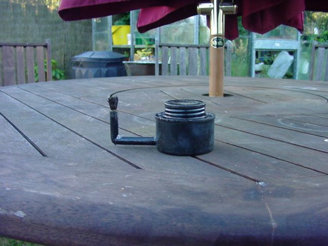

            #46339
            Mark Smith 3
              @marksmith3
              Grand nephew’sengine is now running happlily on meths. I didn’t actually change anything just waited a day and away it went first flick after warm up – they seem to do that. The burner is finished made from a small salmon tin and the top from a solvent tin soldered in. 8mm elbow tube solder at the bottom and my usual fibre glass wick – it works well.
              Bearings are a reasonble price aren’t they.

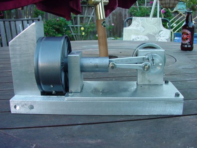

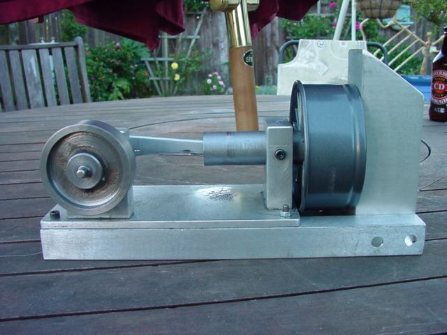

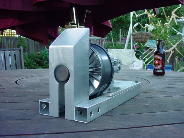

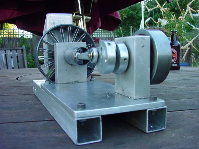

                #46425
                Mark Smith 3
                  @marksmith3
                  Here are a couple of pics of The Devon, my grand nephews engine, nearly finished. I just need to make a base, fit a generator, and a safe box to house it. As you can see it is a Beta and features a cooling unit made from junk parts namely, a heat sink from a computer joined and bent round into a fan. The shroud is a baking ring for pavlova. I got the idea for the stack from one of Roy Darlington’s marine engines. Specs are 25mm bore, 20mm stroke, displacer stroke 30mm. The cylinder is one piece held in the frame with a cap screw, this makes adjustments easy as well as simple to disassemble if required. All the rods and shafts have ball bearings from hard drives and features an aluminium piston with my usual leather cup seal and teflon stuffing box to seal the displacer shaft. It starts easily once warm and runs at a good speed ( can’t measure that yet).
                  Maybe I can now get on with solving the problems with my big pressurised engine…unless another nephew or grandson……….
                  #46438
                  Ian S C
                    @iansc
                    Hi Mark,that looks good,with a tank that size it’ll run for ages.You’d just about fit the generatorunder the con rods,just in front of the cylinder.I see that the bearing I got for the milling machine cost $nz9-50 less GST.The boss said it might be quite expensive!My budget for repairs was $nz50,so that leaves me $40-50 for something else.Ian S C
