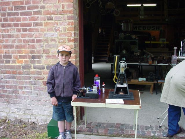

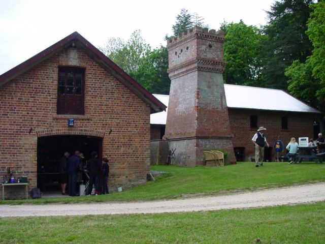

            Mark Smith 3
              @marksmith3
              Thanks Ian for  agreat day at Homebush. My grandson and I had a great day. My engine ran reliably all day as did yours. I was impressed with your engineering showing I have a long way to go. I was very impressed with the hacksaw driven from the large gas fired engine you built. I have come away with “ideas” and a renewed enthusiasim to complete my projects and start some others. I will put up a couple of pics of the day.
