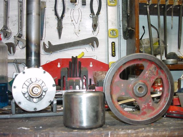

        My pressurised engine is taking shape. The crankcase and side plates are complete with pressure guage and crank bearing set with two dynamic seals. Next step is to turn the piston and the displacer. I have installed a car valve  so I can use my compressor to add pressure before I work out how to make the self pressurising pump. Ian how many engines do you make, Steam? Is a flame licker as powerful as a hot air engine or less so?I will post a pic or two of my latest engine and my vertical engine shortly.

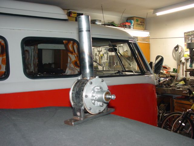

            Very interesting history, Ian. You have done much more than me I am a tyro at this game but learning all the time. I have always been fascinated with engines of all types but non captured my imagination as the stirling engine with its simplicty of operation and its potential. Here is a photo of the first engine I built out of junk. It develops quite a lot of power on Gas. I found that if I hold the shaft at a certain speed the torque starts to increase steadily until the shaft gets hot under my fingers trying to slow it down; maybe someone can explain that..

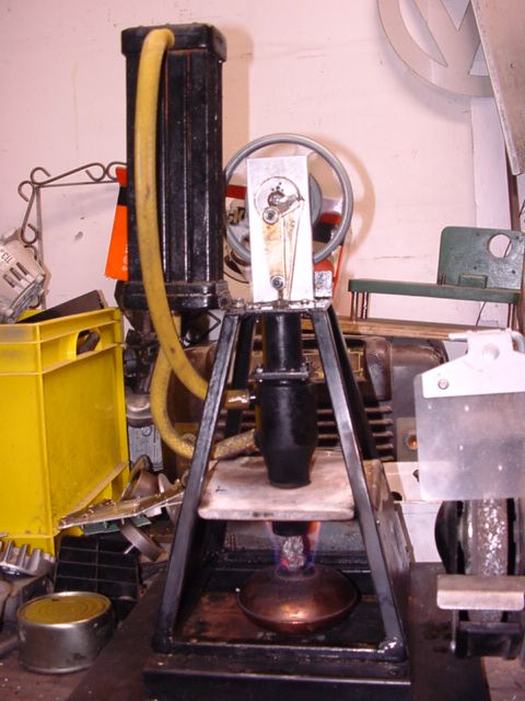

            This engine has a 2cm stoke and a 2.5cm bore seen here running on meths.
            The next engine is my new one designed to be pressurised. It  has a 3cm stroke and 3.3cm bore. The crankcase is from a car generator parted off in the lathe. I then mounted it in the four jaw chuck to face off the part to accept the cylinder flange; quite an undertaking. It made the floor rumble a bit. The cylinder is from a large shock absorber and the displacer is part of a bike frame (chrome molly). I now need to fashion the piston and seals which will be what I found successful to date, being leather cup seal in the piston and a teflon tape stuffing box to seal the displacer rod. I found the pressure guage in one of my junk boxes. At first I have installed a tyre valve to pressurise the crankcase from my compressor until I work out how to make a self pressurising pump driven off the opposite side of the piston from the main crank. I think the cup seal will equalise the pressure across the piston.The crank and seals I have modified from a line trimmer engine. I installed two seals in the bearing set to contain the pressure.
            This last image is of a sugar bowl that will become the cooling jacket and the flywheel I think should work after some turning and truing; hope this is interesting.

                            Closed everything up today and added pressure from my compressor. It leaked like a sieve until I coated all gaskets with cement. Now it will hold 120psi (dropping to 80psi) for 30 minutes. at this pressure It is almost impossible to turn over tdc. But for now I will concentrate on just getting it going at atmospheric pressure to work the bugs out. It seems tight in one place  but I can’t find the cause at present. Compression is very good with bounce but I need to add the big flywheel to help it over tdc as I have only been turning it with a flywheel from the line trimmer – too small.
                            I realise it will be impossible to start under pressure but was keen to see if the rotory seal on the crankshaft would hold pressure and it does, that’s a start at least.

                                      I tried to start my new motor but no go. I need to make the ratio of the piston volumn to the displacer volumn bigger, and the displacer was too loose a fit, but I haven’t got a tube around of the correct diameter so have tried to split a light stainless tube from a vacuum cleaner and braze a section in. The trouble is I can’t seem to braze it without burning the flux and leaving a black mess; tried four times. I have a lot to learn about brazing long lengths. I am going to try using my small forge to bring the job to red heat and introduce the flux and the rod at the same time that way the flame from my blow torch won’t interfere with the flux. The torch doesn’t seem hot enough and the flame is too broad. sometimes the rod melts then it won’t – very frustrating. I look at people who build boilers and marvel at their skill, all those joints and not one leak! I’ll let you know how I get on.
