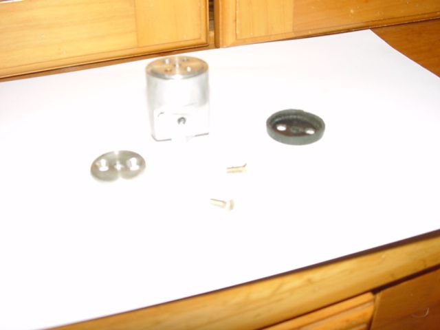

                                                    Now that the comression is better ( actually hard to turn it over) the overheating seams have sorted itself out. I ran the engine for an hour and a half straight on Meths and the water did not boil. Even with gas it didn’t boil and the power output was amazing. I can now make it do some work; don’t know what work yet but something will turn up. Only thing now is that the engine starts and runs with hardly any sound until it gets hot then the piston grows in length enough to lose the clearance between it and the displacer gudgeon at which point there is a light banging noise. I’ll put the piston in the lathe today and shorten it a mil or two that should fix it.
                                                    If anyone is interested , being an Orthotist who sometimes makes special footwear for deformed feet, I know something about leather. To shape the cup I reduce the top 6mm of the piston the thickness of the leather being used (after drilling and reaming for the displacer rod) and part it off. Then I push the piston and the top cap into a short tube the same internal dia as the cylinder with the displacer rod down the centre to locate the parts. Mark and drill two holes on opposite sides and counter sink and tap for 5/32 thread. Cut a suitable piece of leather with enough extra to form the cup depth required and mount it under the top cap. Push the assembly into the tube and heat it from the top with a hot air gun. The heat will shape the leather permenantly. There is no need to wet the leather as it has usually got enough moisture in it. When cool trim to the top of the piston top cap, oil lightly and there you have it. Oh, and I turn a slight taper on the top cap (narrowest at the top) to allow the air pressure to push the cup against the wall. I hope that’s as clear as mud. I will try to put a pic up. It’s a bit washed out but you get the idea.

                                                      I mak my cup seals usually with one hole,and I’v tried soaking in water and on another occasion,oil and pressing it into a hole the size of the cylinder with a piece of steel bar smaller by double the thickness of the leather and with a bolt in the end to centralise things.I read just recently of using the Dremmel tool to feather the edge while the leather is still in the hole,in the past I’v done it with a sharp knife.I’v got a bit of family history with leather,until just before WW2 my grandfather had a leather manufacturing business in Dunedin,during the war he managed a certain large well known company(the one he sold up to),I’v still got some of his tools,and leather!One thing I like to get is an edge that is as thin as I can get,the pressures in the motor are lower than a bike pump (I havn’t actually tested that,but you’d be pushing things to get better than 30psi).Grandpa used to make quite good bike seats,first one I remember was for an ancient bike my sister had about 1960,in those days you could repair things like that rather than throw them away.IAN S.C
