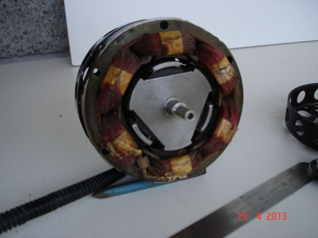

            Hi John, I'v got an old Sturmy Archer hub dyno, I rigged it up to use on a wind turbine(live in Canterbury, nor west winds), I only got two types of wind, too much, and too little. I have run it from my Ross Yoke ALPHA motor.
            As for regulation, I just load things up until the voltage stays stable at the rate that I want. But I'm going to go electronic and use a LM317K voltage regulator so that I can have an adjustable voltage supply. For most work I need a 12V supply for the fan on the radiator, and 6V for the radio.
            Here is an alternator I built from an old 6 pole squirrel cage shaded pole motor that I replaced the armature with a permanent magnet one.
